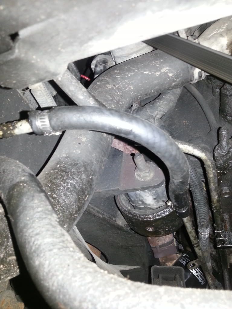

Today I managed to get the caliper affixed to the rotor with a slightly longer bolt. Then I topped up the transmission fluid and decided to ponder how to change the transmission cooler hose.
The hose seems to be leaking a bit and has been for some time. How would I go about swapping in a new hose? Draining the cooler? Is this even the transmission cooler line?

There is no other line under there that looks like that so yea. What I would do is take that one off and replace it with a new one and new hose clamps. Once you have it off you can see what kind of hack job the PO did. If the line ends are flared you will be in good shape. If they are not, you may want to consider getting a tool to flare the ends of the hard line. It will certainly keep it from leaking much better. Don't worry, all the fluid will not leak out, just a little. You might need a razor if the lines are flared. It's an easy repair.
I highy suggest getting a tool to flare the line ends though because if that hose comes off not only will it pump all the trans fluid and leave you stranded, but but it could also spray it all over the very hot exhaust pipe which could lead to your ZJ burning to the ground. Trans fluid is very flammable once it ignites. Have fun!
Also your motor mount looks beat. See how low it's sitting?

I believe that the metal is flared, I was trying to slip the rubber tubing further onto the hard line and was having a hell of a time. It was getting dark, so I didn't want to mess with it anymore in my driveway. I was also worried of a flood of transmission fluid after pulling the line.
I installed a fire extinguisher a few months ago but that would really suck. I'll check the line out sometime this week and see about replacing it.
I'll look into motor mounts as well, most of the bushings I believe are stock from the factory. I don't believe that the previous owners replaced a whole lot before selling it.
Thanks for the help.
