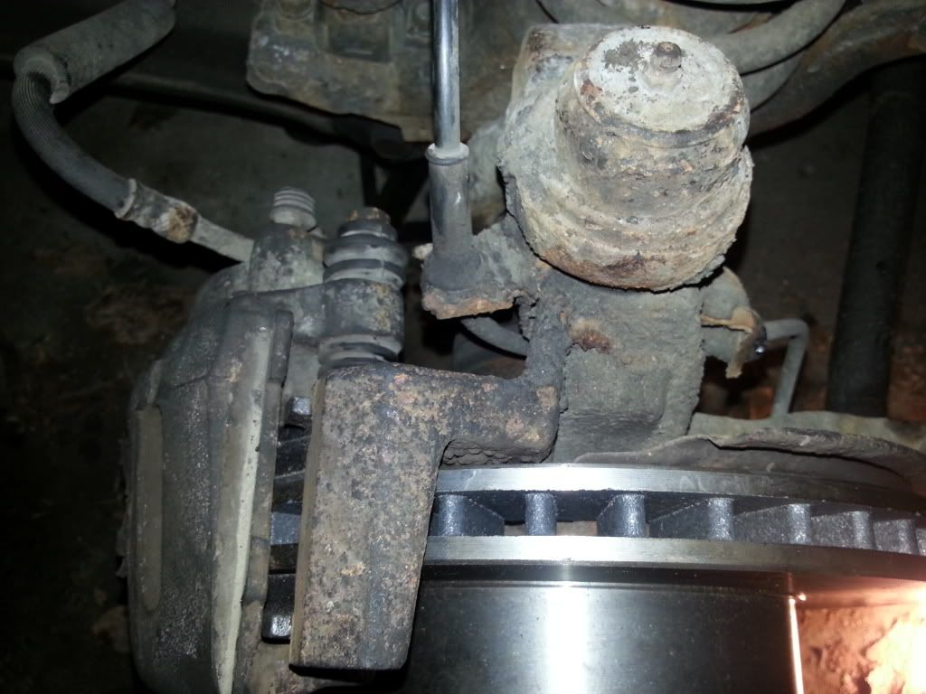

Originally Posted by JColee View Post
What is this peice called? Basically, it's what the caliper bolts to.
Its a caliper mounting bracket
txbass06 is offline
post #26028 of 46822 Old 10-06-2013, 09:32 AM
comptiger5000
Location: Rochester, NY
Posts: 4,556
On ZJs, the front caliper brackets are part of the steering knuckle (as are the pad slides).
So in order to replace the bracket, ill need to replace the entire knuckle?
Hell of a day! A thought to be free brake replacement job done by myself turned into an $80 dollar job.
I'm now boycotting O'reilly. 3 years ago I bought brake pads from them with a lifetime warranty, they stopped producing those brakes and they wouldn't replace them for me or upgrade me even after I offered to pay the difference as long as the warranty transferred. The sales associate seemed to have no idea how to handle customer problems or take some initiative in the situation. So, I went ahead and bought new pads at Autozone then tried to get my front rotors turned which resulted in me buying new front rotors.
Also, I found out that my front drivers side caliper bolt is missing, turns out that the bracket that holds the caliper has stripped threads in the bottom hole. What is this peice called? Basically, it's what the caliper bolts to.
I haven't messed with the brakes on mine yet so I wasn't sure how it was set up. The way he worded it made it sound like the caliper mounted to a separate bracket. Wasn't trying to give out false info
The caliper mounts to the knuckle. The exact same caliper bolt was missing in mine. I went the cheap route and got a slightly longer caliper bolt with a nut to secure it. Put a little lock-tite on it. You can also get a kit from black magic to repair it or get a new knuckle.
Well, I went to Autozone and inquired about the "Limited Lifetime Warranty" as I purchased new pads. They told me that they will cover replacement pads for the life of the vehicle as long as I own the vehicle. So I guess they've got a new customer. O'Reilly even seemed willing to replace the pads, if they still produced them. Although they didn't which was the problem.
Thanks WKBear, I may go that route. I've not dealt a whole lot with brake systems. I'll look into a longer bolt and hopefully that will remedy the situation temporarily. I have a couple junkyards close by, so I may try to find a replacement part from there as well.
How long has yours held?
It's only been a couple months since I put it on, but so far so good. Hasn't loosened up. I used blue lock-tite, though red may work better. I don't have the part number that I used, but I took the other caliper bolt to advance auto to match it up. Only needs to be 1/8" to 1/4" longer. If I had the money I would have just got a knuckle. No jy's around here.
