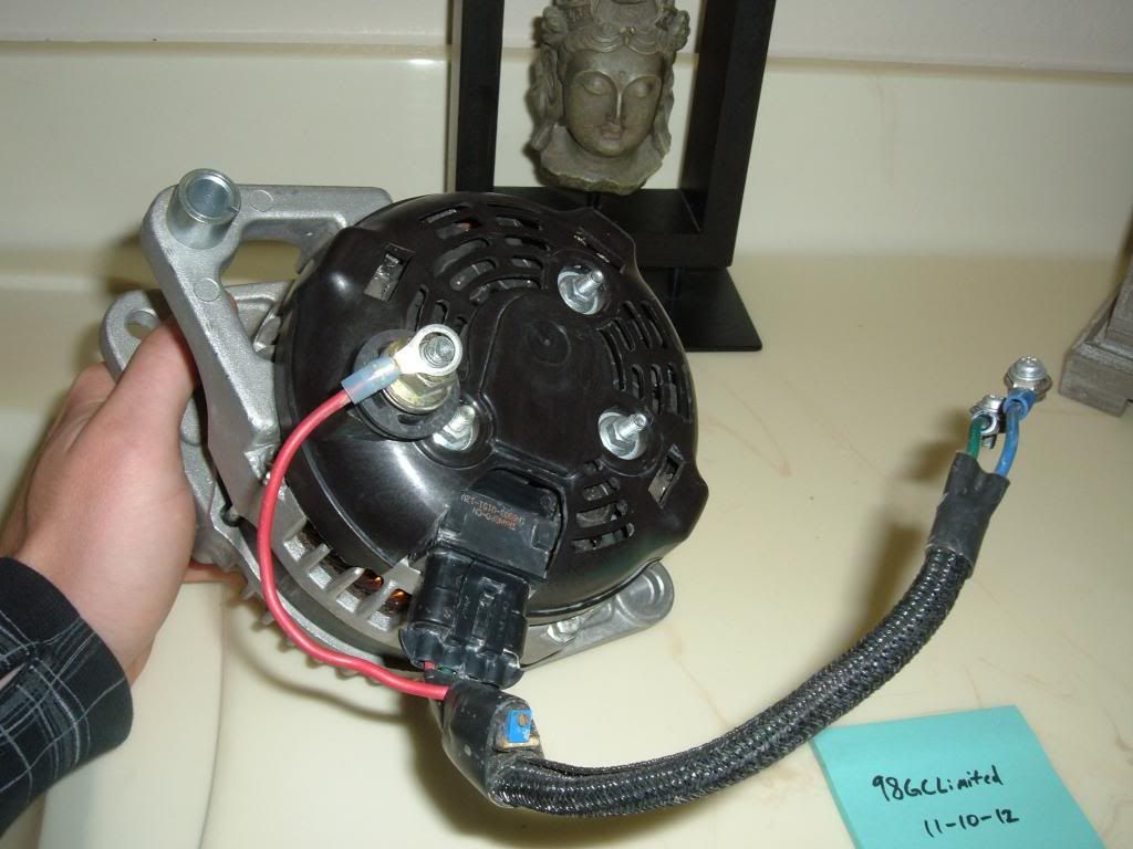

Originally Posted by Maine1994ZJ View Post
Got a free 136A alternator from a Caravan and I was wondering if anyone can tell me if I can make it work on my ZJ....
The alternator the ZJ originally came with:
The Caravan alternator:
Can I make this work, or am I screwed??
Thanks in advance!!!!
Looks like the bolt up brackets might be the same hard to tell from a pic but looks like it could bolt up. And the Caravan alt looks like a 2 wire alt (two wires at the wiring plug on the back and the ZJ alts are also 2 wire.
Like Polka said you could splice the wires or rather than chopping up your factory wiring harness, get some small ring terminals and crimp them on each of the two wires that are coming off the plug on the back of the Caravan alt and then use small bolts/nuts to connect the ring terminals to the two terminals coming off that little black box thats connected to your ZJ alt. Then just heat shrink or electrical tape over the connections so nothing shorts out if it touches bare metal and your good to go. Its simple to do.
Like this setup on my Mechman 270amp alt, how it connects to the factory ZJ wiring. This will help make what I said make more sense.
Showing the plug on the alt itself is incompatible with the factory ZJ wiring but being a 2 wire field terminal system it can be wired up to the factory harness with the two ring terminals and mini bolts/nuts.
Showing the connection to factory harness.
You would want to make sure you electrical tape or heat shrink over those two connections so nothing shorts out. The tape was removed in this picture to show the connections better.
Thanks a Jeep-load!!! Great info!!
Did you take out your alternator just to show me that?
I may just go do that now, before dinner is ready.
JFTR: I DID measure all the dimensions for the Caravan alt. and it SHOULD slide right into place like it belongs there!!
