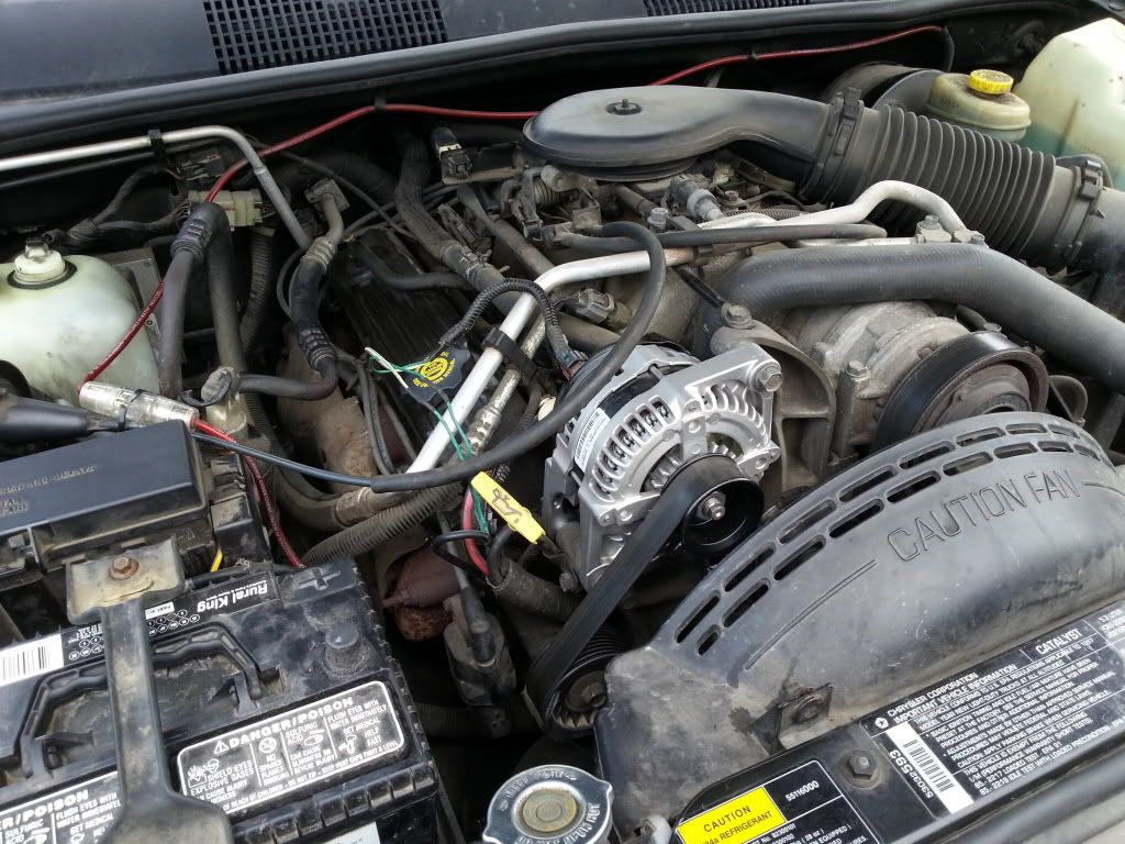

Finally got my 5.9 Durango alternator installed a day earlier than expected. The jeep wouldn't start at first, I had to jump across the starter to get it running again. Hopefully the starter isn't going out, even though I have a lifetime warranty.

That's a 5.9 Durango alt? Is it 150 amp? Straight bolt in minus the new pigtail?

Its a 160 amp from Advance Auto Parts, it cost about $138.99 + tax. It is a straight bolt in, but you have to ground the black wire from your original harness, crimp a larger connector onto the power wire (to connect to the Durango alternator) and then solder in your pigtail. I made mine a tad bit too long and have yet to either shorten it or just tape it up. Here's the thread that I followed:
http://www.jeepforum.com/forum/f13/w...-swap-1330999/
