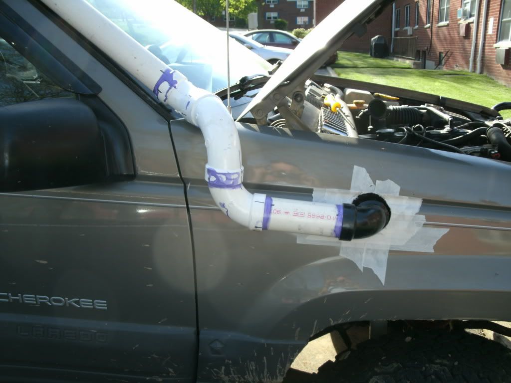

paulyboy
Location: Randolph
Posts: 1,035
Dam jeep was acting up last couple days not starting unless i pushed the gas. Searched it up and tried to clean my iac valve reinstalled same thing......So i went ahead and took the throttle body off and cleaned the whole dam thing up. Wow it was filthy as hell and seemed to be the problem...after that she fired right up on her own and is running sweet now....oh yeah didn't have time the other day to post up pics of the passenger side exit snorkel im making. Just needs paint now.
