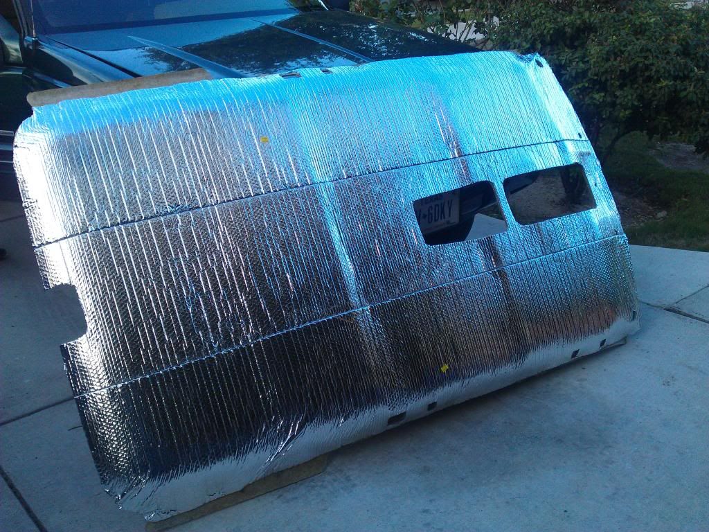

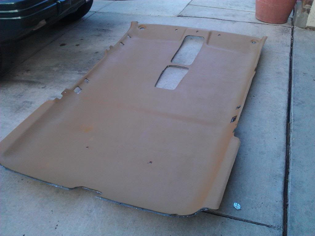

My latest little project to deal with my sagging headliner. I pulled out the fiberglass shell, pulled the material off, and cleaned the foam off with a wire brush. Primed it and painted with some color-matched paint. (Went to Lowe's and had them match the headliner fabric.)
Since I live in San Antonio, heat from the roof is a big issue. Decided to try some radiant barrier. I did put barrier in the center holes after install.
