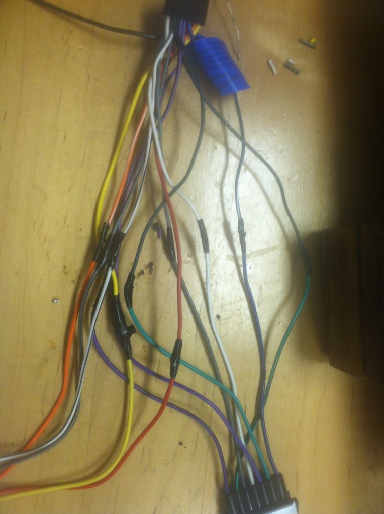

Soldered my wiring harness for the new head unit this afternoon. One step closer to having music!
Twisted wires:

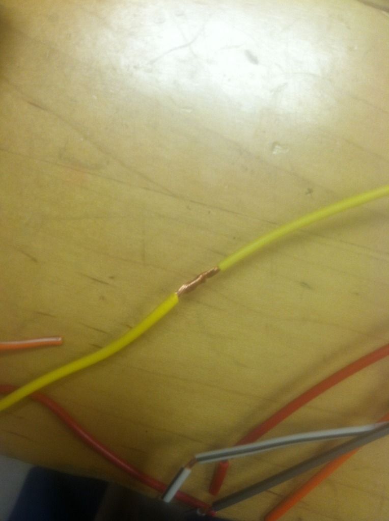

Twisted wires:

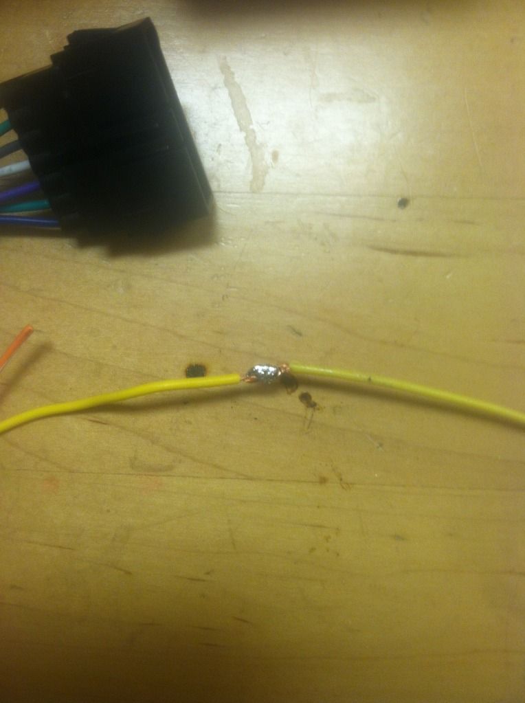

My beautiful solder job:

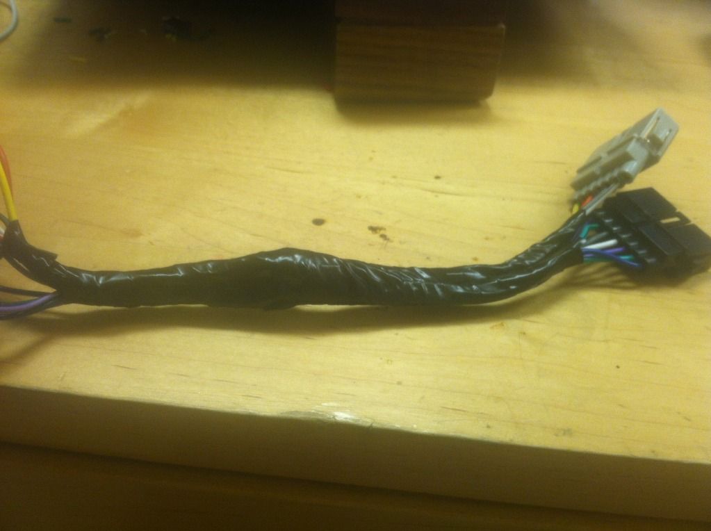

All soldered and taped:
Cleaned up and taped together:
The Western Union solder joints turned out nice!
