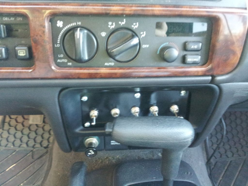

Didn't do a write up but it's simple. Take out the old Vic. Take it apart, trace the cover piece that screws to the box on to a piece of sheet metal and cut it out and drill holes to screw it back in. Also gutted the box to fit the wires and switches hit it with flat black paint and it looks factory

Yours looks a lot better than mine. This one was a mock up that ended up staying. I will probably redo it when I get around to it. I left the back of the VIC also.

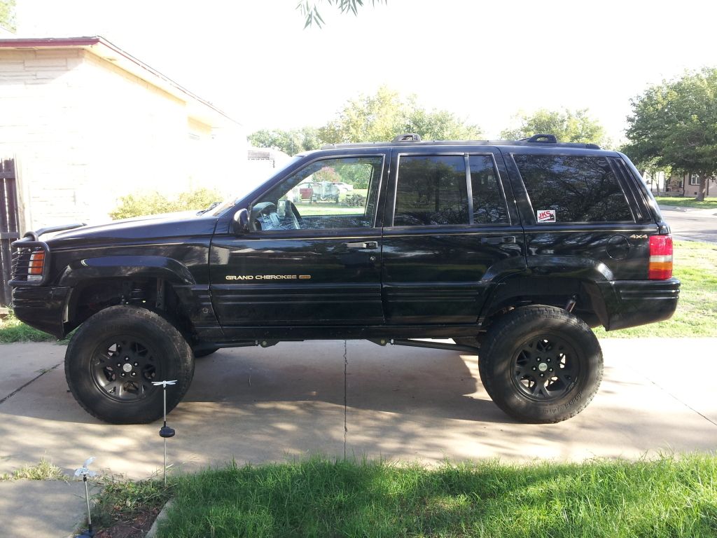

Finally finished my long arms.
