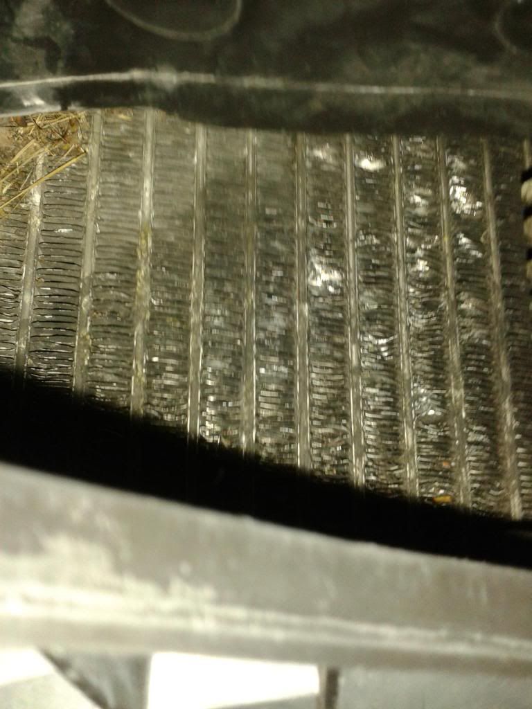

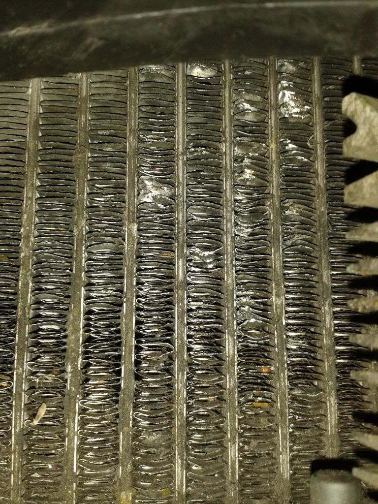

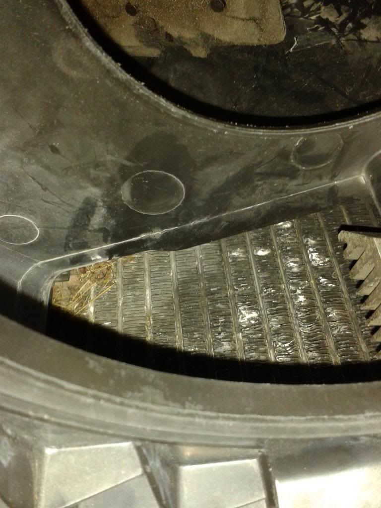

so... i ran the hose upwards, lifted a semi-rotten thing that i suppose was a foam filter on a plastic mount, and pushed the hose in there. turned the vac off and i can hear the hose rubbing just under the dash, a few inches below the glass. its obvious where that goes.
then i tried again as shown it the picture where the crap builduo is supposed to be.
took a few pics of that:
stuck the phone where the fan usually is, faced it left and took the shots. somehow it seems im supposed to clean the crap BEHIND the radiator on the pic?

came to that idea exactly. but honestly, i was a bit afraid to do it. now i see it isnt that hard at all. all i have to do is watch out not to cut into the evaporator.
yaay, found how to spend the afternoon!
thank you for this, i hope this does the trick and i wont have to be boring again.
