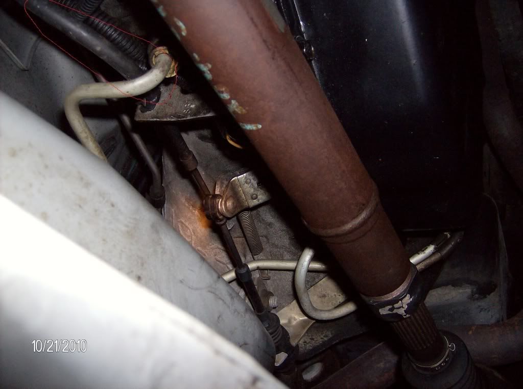

I should note i was hearing a scratching noise under the Jeep 2 days ago prior to this i thought was the suspension so i went down and started wiggling things. When i wiggled the drive train tho the noise was coming from somewhere on the tranny, i found out its the cable AFTER the spring on the throttle valve. Its black sheethed and goes up over the transmission in the back. That thing was causing the scratching noise it was rubbing on something. So i moved it a little and that noise went away and then all this started shortly after.
I just went down there and wiggled the cable and tried to reach up top on the tranny where the cable goes to see if something was rattling again and i took it for a drive and the pop/rattle seems to be gone im not 100% sure, but that hissing/slurping noise is still there when im driving...
If your confused about the cable, its this one right the part i circle in red.. Thats part of the TV cable well its attached to the lever anyway.. it goes up on top of the transmission.. what all is up there ? Cause since i moved it on top a little to stop the squeeking noise it was making (rubbing on something) thats when all this started happening.

The fuel line as someone mentioned earlier goes directly above the transmission.. Aparently there are brackets on the line that bolt into stuff to keep the line stable. Well there is a bracket directly below the tcase and tranny shifter levers... I just found that bracket on mine and mine the bolt was gone.. Musta rattled loose..
That bracket is like MM below the floor board on the shifter handles. I twisted the bracket down outa the way and took it for a test drive just now... Boom poping vibrating, grinding noises are gone. Slushing slurping noises are gone as well..
So it wasnt the tranny, it was a stupid peice of crap bracket... I guess when i moved the black sheethed line connect to the TV cable lever outa the way on top of the tranny it also dislodged it from the fuel line, and since that was the only thing keeping that fuel line bracket from vibrating on stuff thats how all these noises started..
