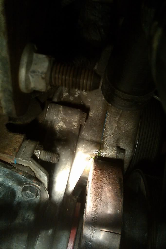

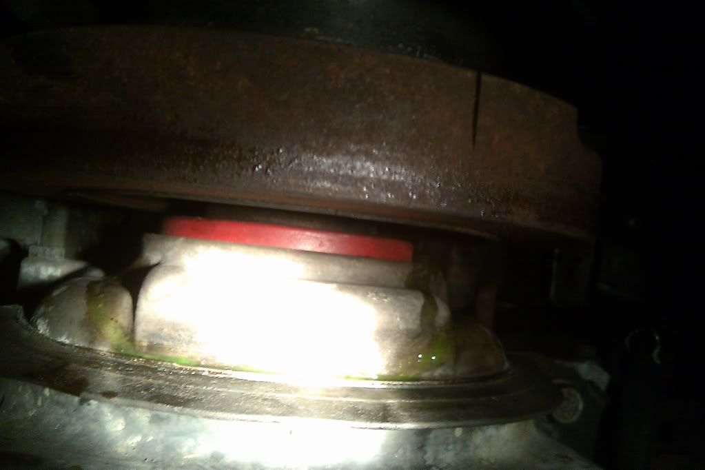

post #15 of 25 Old 08-23-2011, 08:21 PM Thread Starter
Candymancan
Location: Virginia
Posts: 5,548
Here are couple pics, i checked the weep hole just now and its dry as a bone, so its deff the gasket on the bottom
See that corner bolt above the balencer ? Thats where i think its leaking from that or the middle between the 2 bolts on the side where i cant see cause the balencer is in the way
