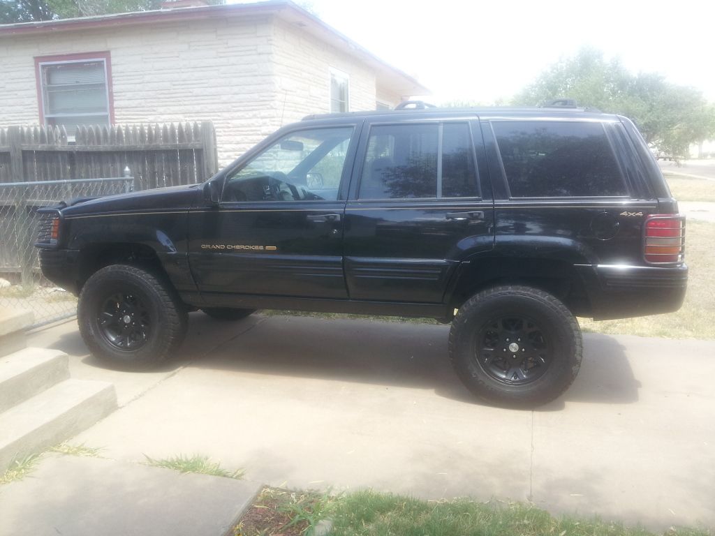

I was excited to see my jeep in your first post! It took three hours to finish those wheels. I used three cans of plastidip and I have half a can left. It's $6 a can from Lowes. I have been asked if the wheels are aftermarket. I washed them earlier then wiped them down with Acetone right before I sprayed them. I tested with just spraying over the gold but it didn't work very well. Taping over the edge of the tire and spraying went fast.
Here is a better shot in case I didn't post it in a different thread. This is the best $18 I have spent on the ZJ so far.
