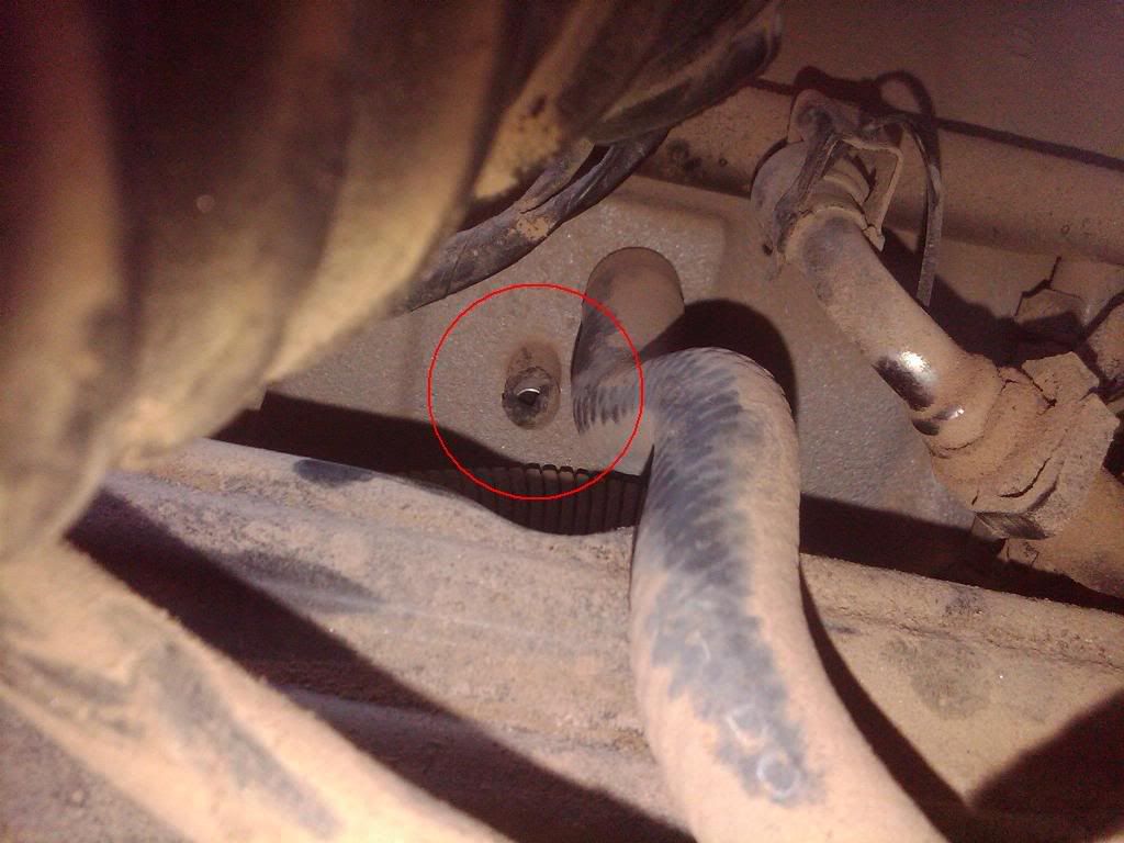

I found where the leak is coming from.
This first picture is just for reference.
Here is where the leak is.

What is that thing called?

is that the hose that goes from the master? I think that would be pretty easy to replace, it looks like it would just pull off the fitting at both ends.

I don't think it's a hose. It looks like it's just a plug that goes over that small tube.

Is it like a rubber plug thats covering a little hole there? Let me go look to see if mine is similar.

Yep that's exactly what it is.

From looking at mine, I didnt want to rip it out, I think you could get away with RTV for the time being. It seems like there is a little nipple that is flared on the end that holds it in place. Might be a dealer specialty part.

I don't know if I would put rtv there to potentially get suck in. It doesn't look like a very unique piece though. I'm sure you could find a plug somewhere. Even a tapered plug with a head maybe?

I grabbed a pair of needle nose plyers and got it to come off. It looks like a little rubber end cap. I wonder if autozone would supply it.

When you find them, pick up a bunch of them. If that cap is shot, you can bet others of the same vintage are not far behind.
