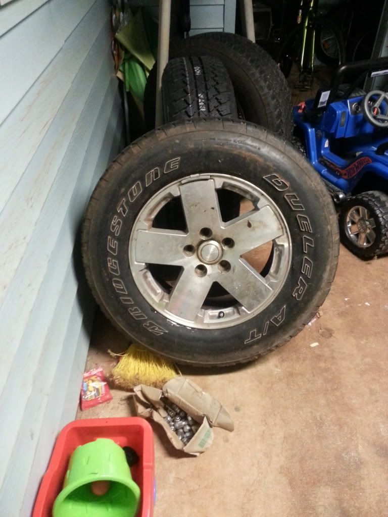

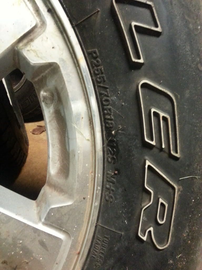

[IMG][/IMG][IMG][/IMG]
So I went and got them. turns out it wasn't brand new tires, just one was new, the rest are around 60% tread. But the rims looked good and the tires are still way better condition than mine.
They are WAY bigger than the wheels I have now though. I was planning a lift of some kind because I'm pretty sure my suspension is finished, but I figured better not pass on this deal, and if they don't work with my new lift then it won't be hard to re-sell them to get my money back.

Those are JK Sahara wheels and tires, 18" rims (~6"BS) and I think 32" tires. You will need the adapter spacers mentioned to bolt them on, and even then will have a lot of difficulty running them without any lift. They'll rub like crazy.

ZJs have a 5 on 4.5" bolt pattern, JKs have 5 on 5" bolt pattern. They are not a direct fit. You can run 1" thick spacers that convert from your current 5 x 4.5 to 5 x 5 and they are safe to use. Other option is to take your unit hubs and rear axle shafts to a machine shop and have them re-drilled to correct bolt pattern (= $$$, and you'd need to always re-drill unit hubs when they need replacing).
What you need to know is the difference between tire diameter and width:
* Largest stock ZJ tire size has been 245/70 R16 (30.5" diameter).
* The tires you've got now are 255/70 R18. That would equal to a 255/80 R16 tire, which in turn is roughly similar sized to a 265/75 R16 -> close to a 32" tire.
Those tires are on a 18" x 8" wheel, but I don't know what the JK backspacing is; most likely they have quite a lot of backspacing so you're ok to run 1" thick spacers to convert to correct bolt pattern. 255 is only 10mm (or 3/8") wider than the stock ZJ tires, so you can most likely fit those running 1.75" or 2" budget boost lift, and adding maybe an inch of bumpstopping.
