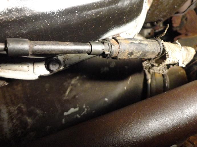

Hey all,
What is it I'm adjusting here? Should I have all the clips and things on when I I'm adjusting it so I can just pop it back in the mount? Nothing seems to move when I spin it.
This is what it looked like when I popped it off.
I took off some clips and things and thought I'd spin the bottom of the arm, but it doesn't seem to be moving like i thought it would.
Any advice? Thanks!

This piece just pry's open. Hope you didn't destroy it...

Thanks Rich. It's in good shape. So do I keep everything on except for the plastic clip? I put the tranny's lever and shifter to park already. Do I just hook it up? Where's the adjustment, I'm just not seeing it.

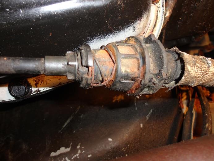

Leave in bracket
Unlock the cable clamp
Pop the end off the shift lever At the transmission
Place lever fully in park
Rotate adjustment collar at the bracket till you can pop the end back on the lever
Lock it down
If no adjustment was needed, you have other problems.

Thanks Rich and Ratmonkey, I got it sorted out tonight.
For anyone else following along, after I cleaned up all the gunk on both pieces, I was able to slide the skinnier section through the part Rich circled. By slide I mean I used a small wrench + hammer.

Well, it was tap-tap, not smash-smash. I'm telling you though, there was no cable to adjust. It was that plastic cylinder with ridges that had to move in and out. And yep, it was very quick once I realized what needed to happen.
It's only been a day, and I've only bounced around my property, but so far so good.
