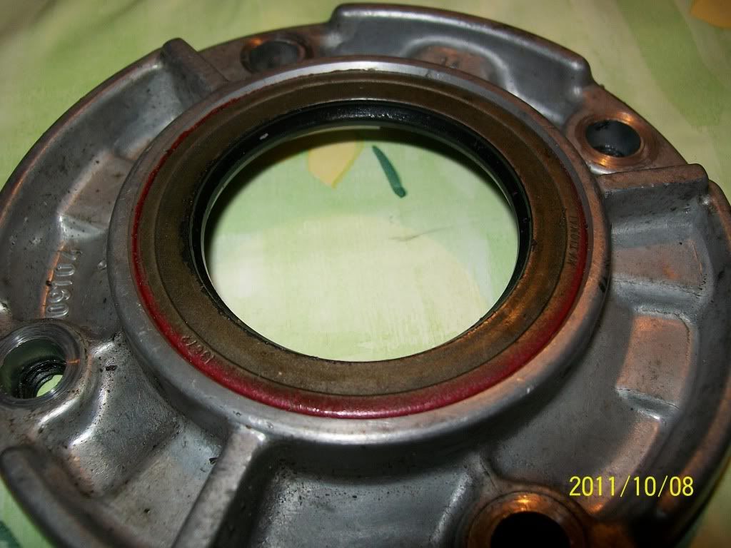

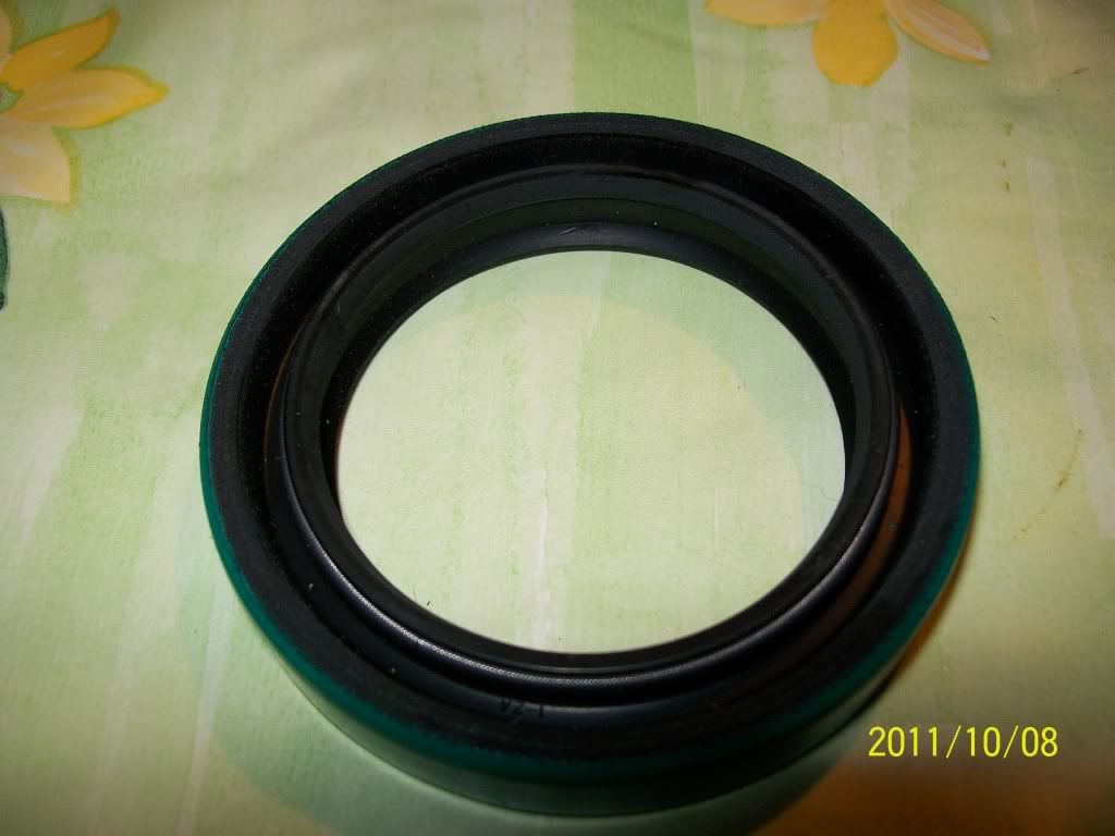

I'm not sure the guys at Napa gave me the right input seal.
This is the original one in the 242:
This is the one from Napa:
They look completely different. I think the one from Napa will fit in the front bearing retainer... and I know the input shaft from the 242 will fit through it.
Both sides look the same. One lip with a spring around it. Is this right? My friend thinks it might be a newer version of the seal.
Any ideas

post #761 of 3320 Old 10-08-2011, 11:03 PM
sskilla
Location: sacramento
Posts: 818
Originally Posted by Mediokrates View Post
Hi all,
I think I need some help.
OK, my first snag... I can't get the yoke nut loose. I had a guy holding down the transfer case, while I torqued the nut, but it wouldn't come loose. I just ended up lifting the guy up off the ground. I might wait until one or two more big guys show up to help hold it down.
But from what I can tell, you only need to take the yoke off to change the front output seal.
Talking about seals... I kinda worried about this.
Any ideas
the front yoke is tuff. i had a big @$$ pipe wrench on the yoke itself and my ratchet with a breaker bar on the nut and managed it. soak it with PB blaster if its really stuck and give it another go.
that seal from napa is the double lip seal that JrMechanic recommends in his write up. its good, i used the same one.
keep us informed

I used that same seal that youre wondering about above, and its working great

The guy from Napa told me it was the single lip, but ok, my bonus.
Does it fit flush with the rim of the retainer, like the oe seal, or does it protrude?

the seal should sit flush i believe
