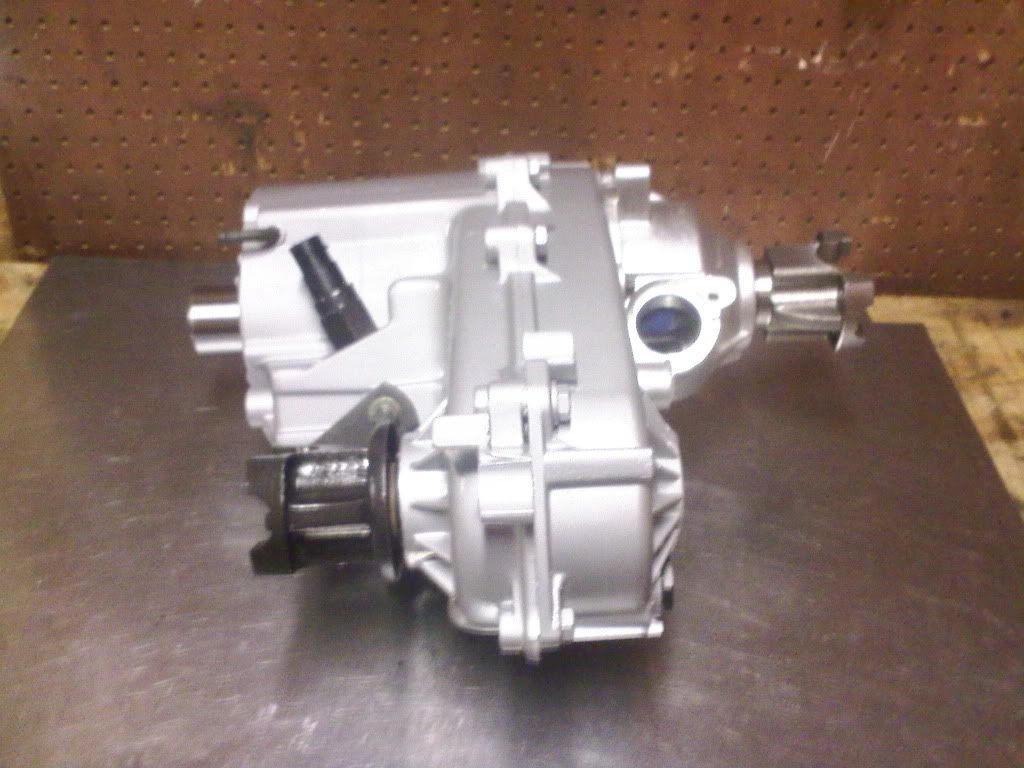

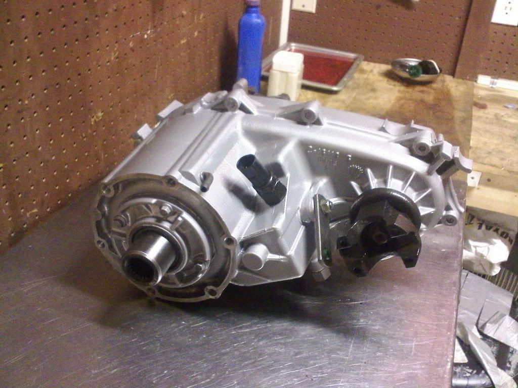

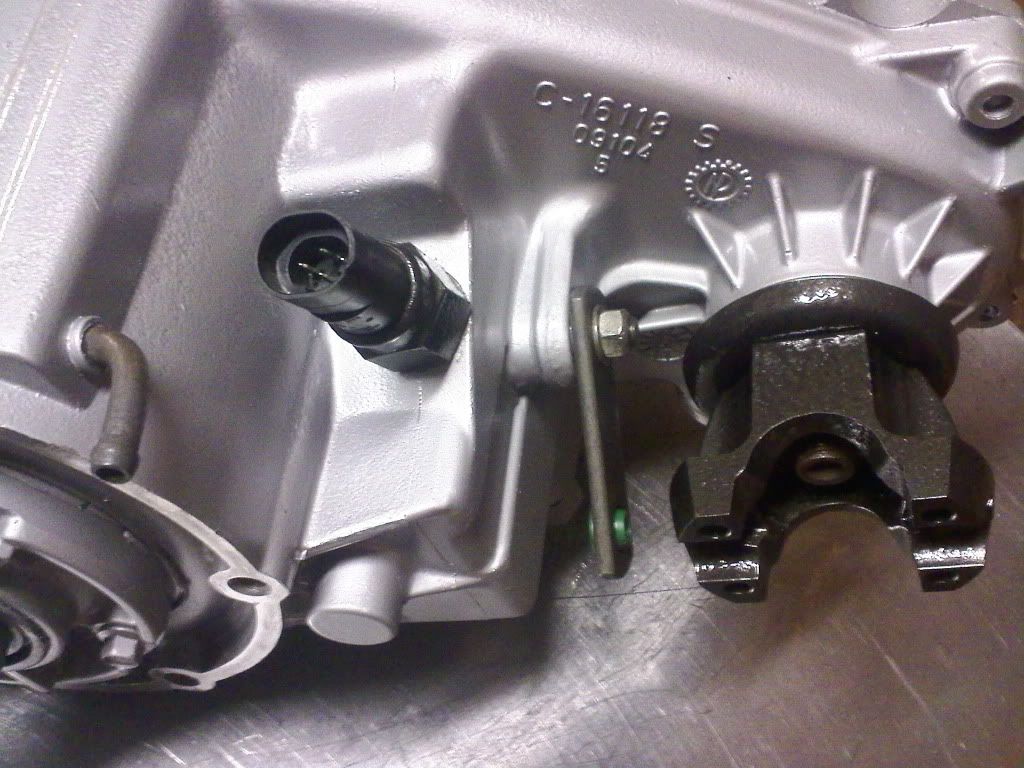

Here's a 231 I just finished up for another member here. It was fully rebuilt along with a Rugged Ridge SYE, and a 1.55" input shaft:
Is that for a 4.0? The 249 inputs are around half that length. (on the 5.2 anyway)
It was built specifically for a '95 5.2. The 46RH utilizes a 1.55" input.
Ahhhh, gotcha.
