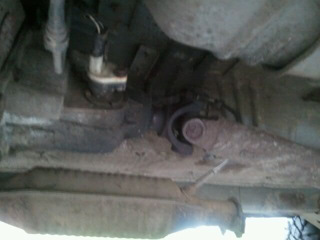

Whatsup guys, i have a 96 v8 zj with the 249, and i just picked up a 242 out of a 96 zj for my swap. However, where the rear drive shaft would go is different. I read this thread and im guessing my zj has an internal shaft, and my new tcase has an external shaft. Can someone verify that based on these pictures...
Also, what can i do to make my new 242 work with my jeep? If it helps the build date on the 242 is 96 1 and my current tcase appears to be 96 6, but the last digit is pretty beat up, i think its a 6.

You got lucky. That's a direct swap, as long as the 242 came from a Grand Cherokee. The rear output shaft on the 242 is a bit longer than the 249, so you may need to cut off .75" to prevent bottoming out.

wow, thats good news thanks. But hows my drive shaft going to connect to my new tcase? Im guessing that one piece, with the ujoint, comes off my old t.c and goes on the shaft of my new one?

Same as the old. It just slides on and off. The boot (black rubber thing) goes over the yoke and just ziptie it secure when you get everything bolted up.
You don't have to take the front ujoint out to do this. Just the one at the axle.
