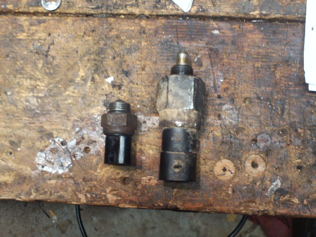

i pulled the(Stamped 92-93) 231 out of my 93 today and it has a huge 4 prong 4wd switch and the (Stamped 93-94)231 with the SYE im putting in has the 2 prong 4wd switch any reason why? both input gears seem the same 23 spine
one had a green speedo gear and one had a orange speedo gear

Swap the switches and speedo gears over from the OEM case to the doner case.
well that was a fail the 231/sye will not shift with the bigger connector and the smaller connector is only 2 prong and not 4 prong but shifts fine what do i do?

Looks like your using the wrong case for your swap

no not the wrong case had to crack it open again and swap out the shifter pattern thingy in side now all is good
