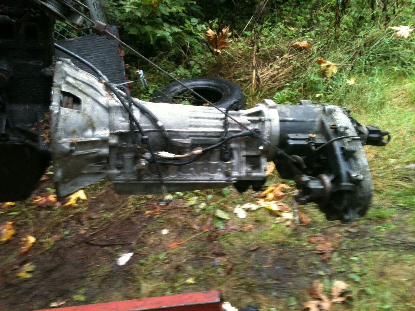

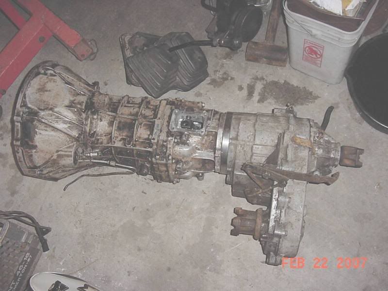

AW4/Jeep NP208 with Parts Mike's 1" clocking ring (NP219, 228, and 229 from '80 up FSJs fit also but 5" longer) It could also be used with a Dodge NP208 for RH drop front shafts. I think it was originally made for D300 to AW4/AX15 but I'm not sure.
AX15/NP208J
