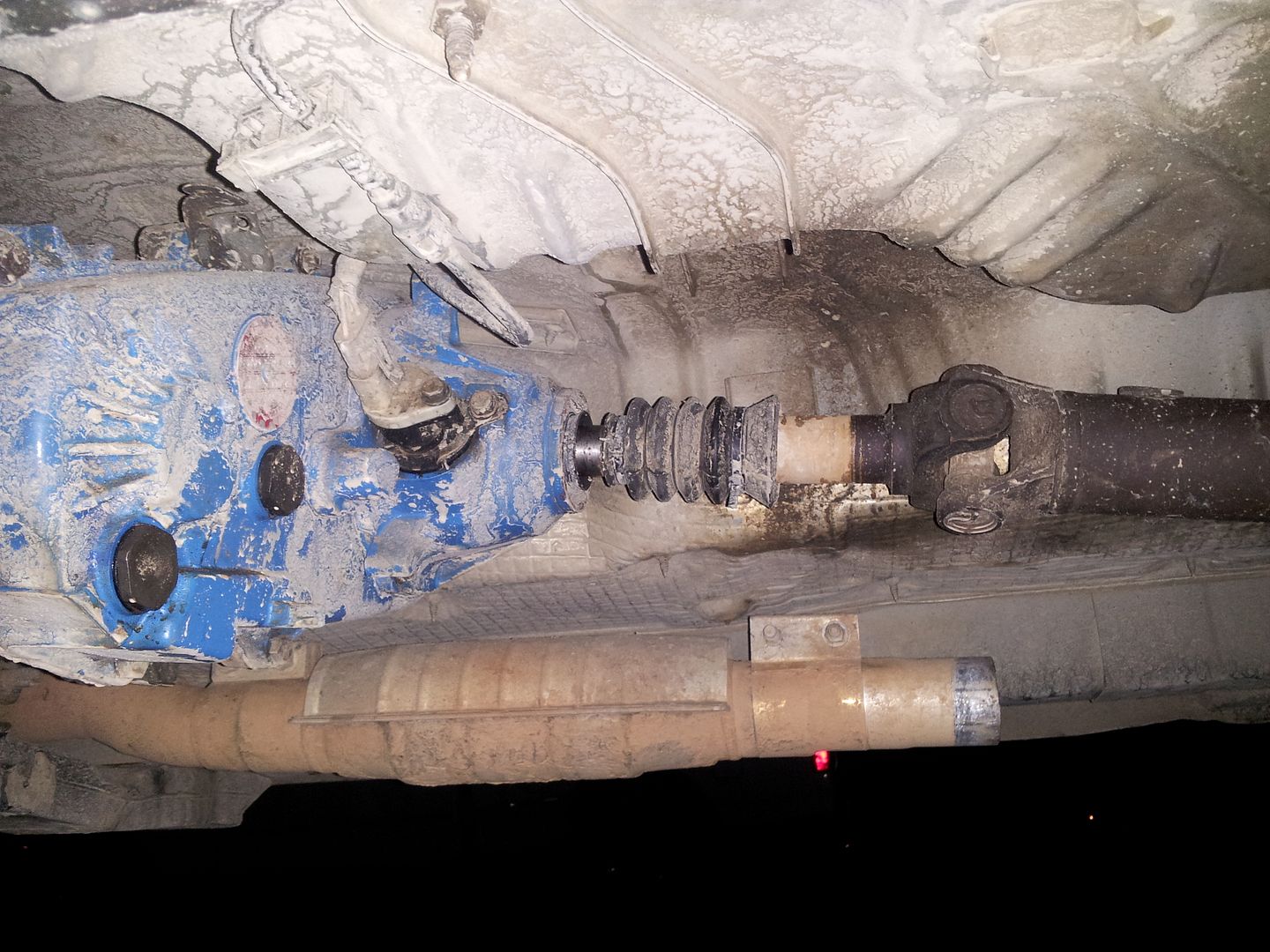

Originally Posted by Platinum5nine View Post
I think you guys shortening the shafts feel the yoke slips more than it actually does. The driveshaft moves very very little in either direction unless you compress the suspension to the bump stops on both sides in the rear at the same time which is not going to happen unless you jump it. Im going to get pictures of both my ZJ's tomorrow showing the yoke at the transfer case. Would be cool for you guys to do the same just to see where everyone is at.
Mine had to be shortened 'cause with it 100% bottomed out it was still too long to even fit under mine. I had it brought down two inches, so I have about 1 1/2" travel both ways. You can't really see it in the picture I just took 'cause of the boot though. haha

post #1780 of 3442 Old 10-24-2013, 09:13 PM
Muzramp
Join Date: May 2013
Location: West Palm Beach
Posts: 93
I was thinking of shortening mine 1.5inch. The way it is now. I cant get it to even bolt on. It needs to be 1/4 in short just to get it to slide into the ujoint. And thats with it 100 percent on the yoke. So Im thinking 1.5inch short will be a good measure. I dont offroad or anything

post #1781 of 3442 Old 10-24-2013, 09:18 PM
Platinum5nine
Join Date: Jun 2013
Location: Middle Island
Posts: 510
I really dont understand why some of us have no reason to shorten the driveshafts yet others do? Just doesnt make sense.

Myusername1674
Location: Chattanooga
Posts: 2,310
That's exactly how mine was, so yeah you should be fine with 1.5 inches.
Well it's because of all of the different variables.
93-95 had longer transmissions and all had the dana 35 rear.
96-98 5.2's had shorter transmissions, but longer rear axle pinion; the dana 44a.
96-98 4.0 had different transmission (I think shorter than 93-95) and had the dana 35 rear. So these had longer driveshaft then the 96-98 5.2s.
Then you've got the 98 5.9, which I think has a different transmssion even then the 96-98 5.2.
On top of that, depending what case you swap in will make a difference, after 96 (I believe) Jeep transfer cases starting coming with an external slip yoke, which was 1.5 inches longer than their internal slip yoke counterparts.
Then you have the fact that most guys on here have lifts on their jeeps, anywhere from 1" to 5", and in some cases even higher. So basically, there are just too many variables to be able to determine unless you just do the swap and find out for yourself.
