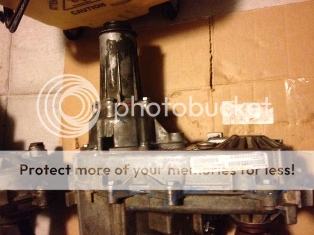

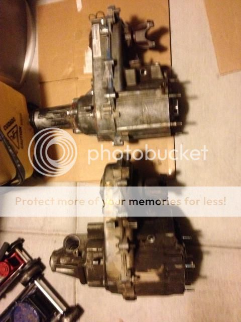

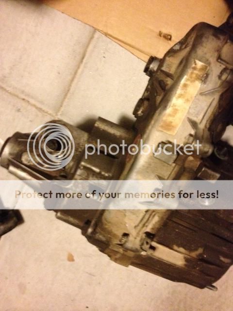

Here are the cases side by side. The dirty one is the just removed 249, the other is the case in question. No SYE, actually longer tail piece, and larger rear shaft, no place on the case to connect the speedometer.
The case in question, where the speedometer pick up should be
The 249 where the speedometer pick up is located

It's probably from a newer than a ZJ Jeep that uses the ABS tone rings for speed.
Not if it's a 231. WJs only had 242s and 247s. It could be from a KJ or KK, or maybe a JK though. I dunno what those use for speedo pickup.
comptiger5000 is offline
post #1552 of 3430 Old 03-03-2013, 04:12 PM
ejschultz
ejschultz's Avatar
Location: Cedar Lake
Posts: 3,515
Yeah. At first I was going to say from a WJ but realized it was a 231. KJs and JKs I believe would be the same as a WJ though. KKs are electronically controlled.

Not sure what it is either, maybe a 231-AMC (YJs and Wranglers). I don't see a hole for the speedo on this one, but the angle is bad. I found this pic on ebay.

The YJs had a cable driven speedo on the tail. They also have vacuum range selector... Not sure sure any other wrangler though.

TJs have electronic speedos with the sensor on the t-case, like a ZJ / later XJ. I dunno about JKs though.

Probably from a liberty.
