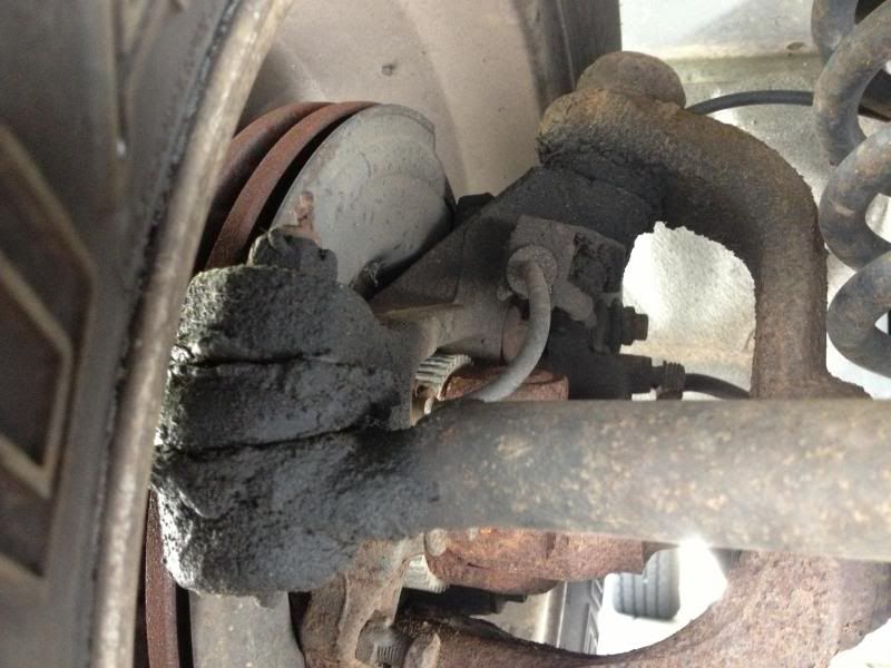

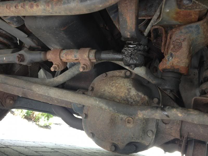

ive been doing some more visual inspections under my niner when i have time recently. im essentially checking things as i learn about them here and on other forums. recently i noticed that the joints at the end of my track bar seem to be completely gobbed up with grease. i dont know what else to say, but they dont look good. what do you guys think?

I had a power steering leak, looked similar to that. I cleaned it all off, check the bushings. no problems for me

hmm didnt think of that. my main concern was the drivers side bushing. as you can see in the picture, its not only caked with grease, but it almost looks like fresh/wet grease. \
forgive the noob-ness, but what would you recommend looking at in order to determine if there is a power steering leak?

That's the drag link and tie rod. I'd say the driver side is pooched since there is no evidence of a leak and the passenger connection might be in bad shape. Only way to tell is to clean up each joint and look to see if the boot is torn.

on the topic of this thread, that is not a track bar, the track bar is directly behind that drag link, if you want to know if your track bar is bad have a friend turn left and right while watching for what looks like "hop" in the tie rod end of the bar and wiggle on the end connected to the axle
