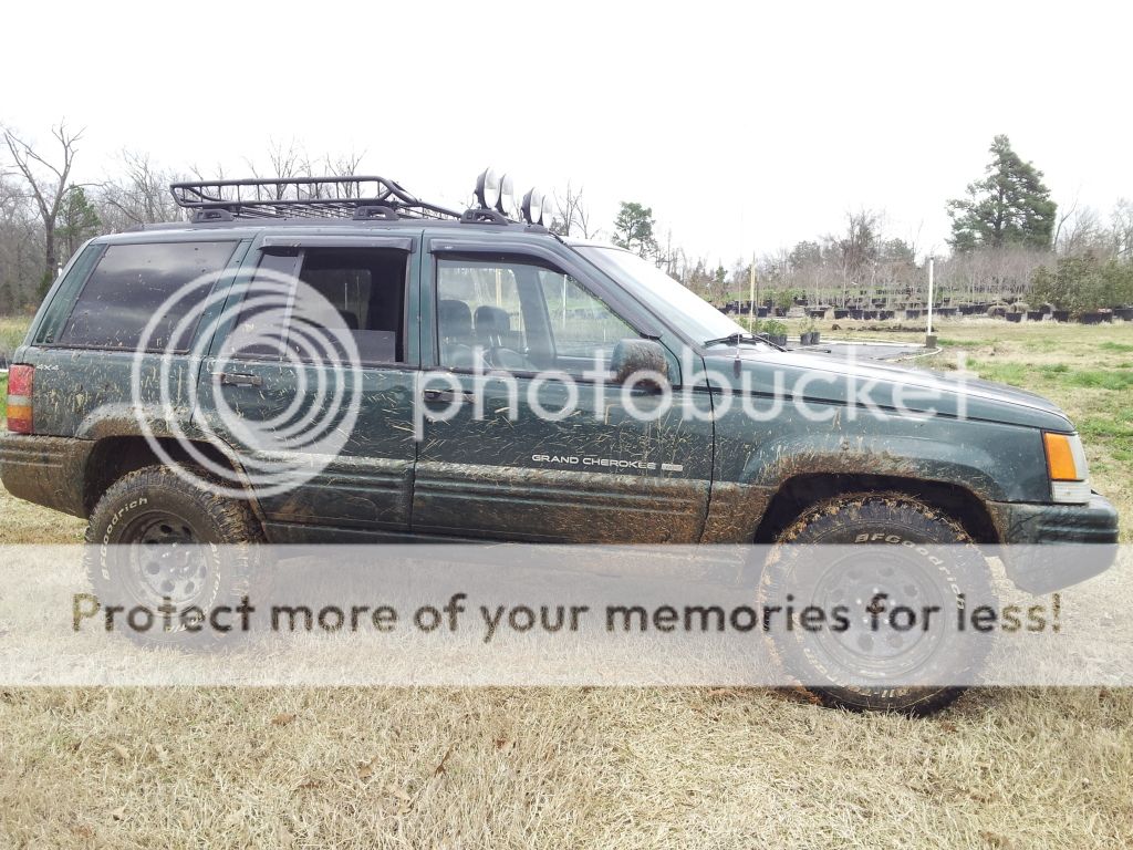

Granted I am completely stock, with 225s. But I flexed her out pretty good yesterday. I was disco'd in the front. I believe my tire hit that lovely pinch weld once or twice. Made a noise here and there. So even with stock tires, I still managed to hit inside the fender well. My advise is to just be careful flexing with bigger tires.
