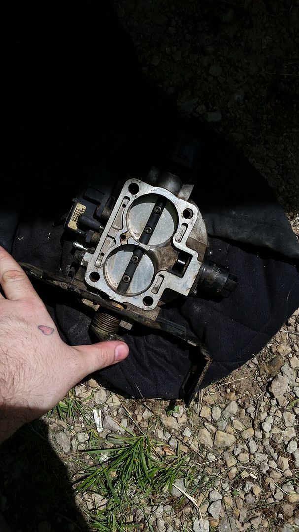

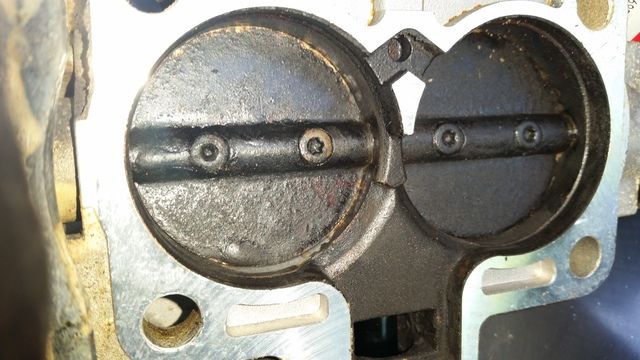

post #10 of 15 Old 05-07-2013, 08:56 PM Thread Starter
JohnCrabtree
1994 ZJ
Join Date: Mar 2013
Location: Sonora

post #11 of 15 Old 05-07-2013, 09:03 PM
dnuccio
Location: Phoenix
Posts: 3,483
That's what mine looked like. I cleaned it and it runs so much smoother now. IAC valve was very dirty as well
Reliability is relative
R.I.P. Ratmonkey
dnuccio is offline
post #12 of 15 Old 05-07-2013, 09:06 PM Thread Starter
JohnCrabtree
1994 ZJ
Join Date: Mar 2013
Location: Sonora
Posts: 314
I completely forgot about the IAC... I had to help someone take a chopper out of a truck right in the middle and it distracted me.

post #13 of 15 Old 05-23-2015, 06:15 PM
lunchfist
Join Date: Jan 2015
Location: dubuque
Posts: 70
Before and After:
lunchfist is offline

post #15 of 15 Old 05-24-2015, 08:49 AM
PolkaPower
Location: The Abyss
Posts: 20,148
You should cut it smooth, sand polish it up while you are at it. I bored to far down past the throttle plates and had to make new ones out of brass. That part was not easy.
