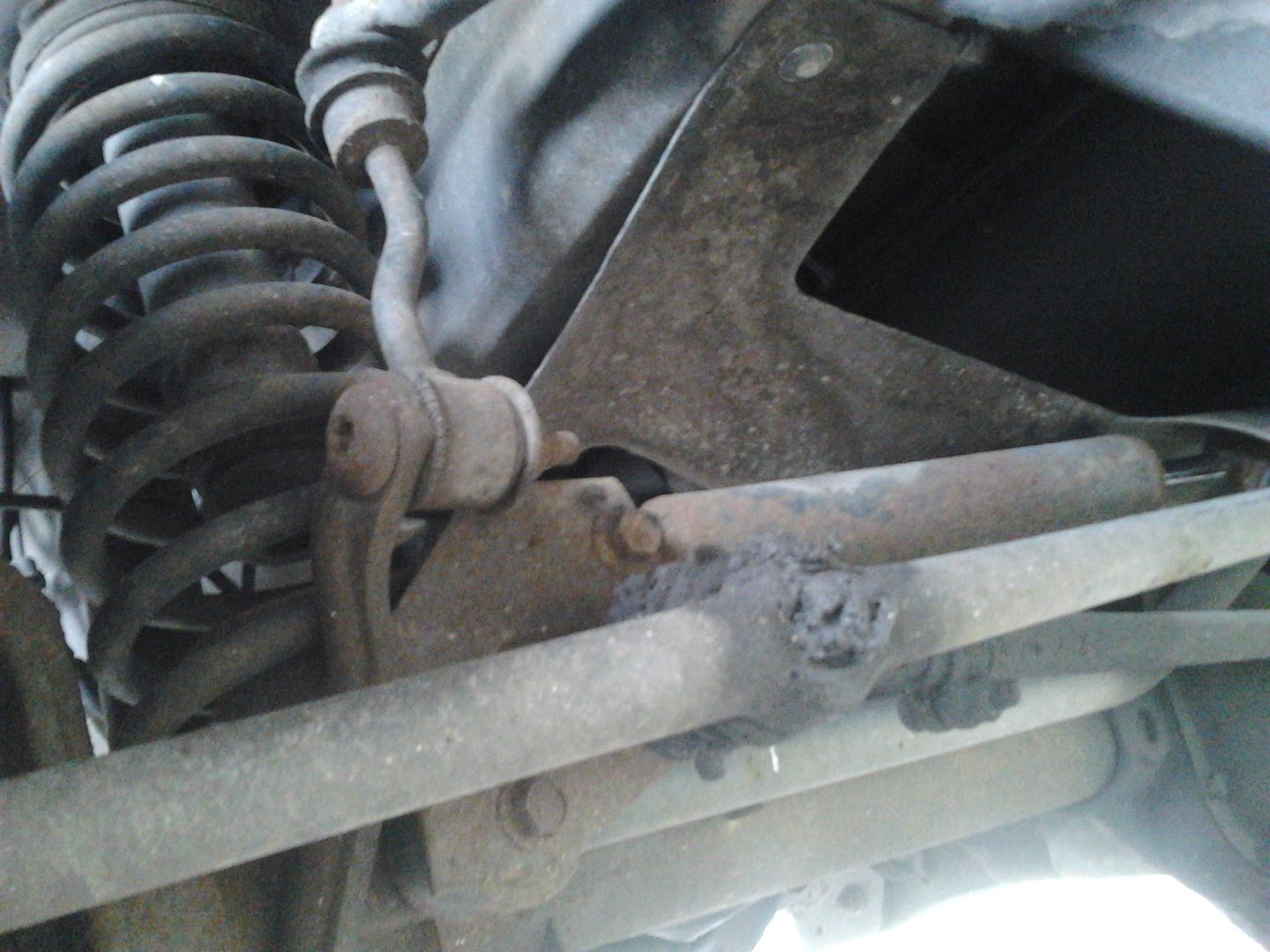

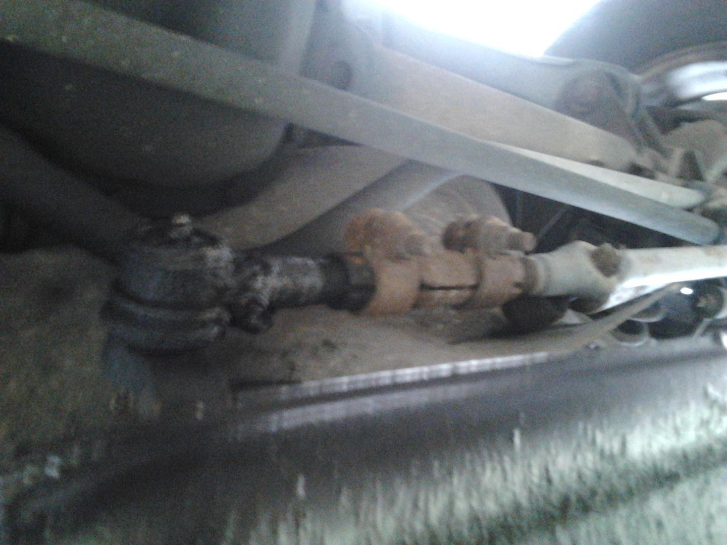

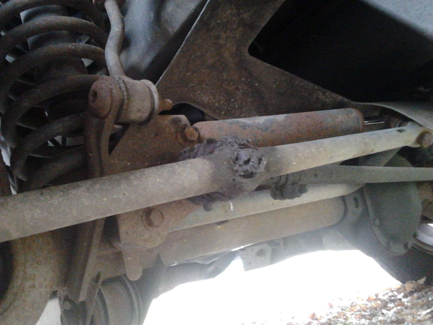

I have a 97 grand cherokee laredo (manual says that it's a TSi) 4x4 6cyl.
I'm having a problem going over bumps, just makes some creaking/popping noises. took it to a mechanic down the road from me. Got it back the next day he said that it was the sway bar links and bushings on the front. I'm not 100% sure I really believe him, because for one he wants $360 to replace them, claiming $117 was for parts, yet I look at autozone.com and the parts are under 20... also should mention this guy has an F rating on the BBB. I have help replacing the parts, but I can't get a second opinion until a couple days after Thanksgiving, and I really do not want to wait that long.
Got under the jeep and took a few pictures of the general area by the swar bar links.
Sorry for the quality of pictures. Was just wondering if anyone could spot something that looks terribly wrong, because I really don't know what it should look like to begin with.

GTO71
Join Date: Oct 2012
Location: Nothern Pangea
Posts: 118
Sway Bar
He is a scammer, gives mechanics a bad name. The bushings look bad, you can get replacements foe 20 bucks and do it yourself, just spray them down for a few days with PB Blaster to break free the rust or you might break the sway bar link like I did, but evan them they are like 30 bucks from the auto parts store

Yup, definitely a ripoff.
If you have the time (probably 1-2 hours max for first timers), a few sockets and ratchets, you can do it yourself quite easily. Pictures won't really help here to diagnose sounds. Get under your car, have someone push down on the bumper to recreate the sound and listen to where the sound is coming from. If you still are not sure, disconnect the end links of the sway bar and push down on the bumper again. If the sound is gone, it's the sway bar bushings.

Please don't ever take your ZJ back to that mechanic.
Sway bar links are a 20 minute job. Unless you have to grind off the torx bolts. :
I replaced the torx with regular hex head bolts so I'll never have to deal with it again.
Tie rod ends good? Sway bar bushings good? Drag link and track bar bushings and joint good? Ball joints good?
Jack the entire front end up (not using the axle tube so the suspension is hanging freely) and try to move all the joints around by wiggling stuff.

Not sure where the $20 in parts is coming from and I'm seeing about $70 and that's through Amazon. That's for 2 Moog sway bar links (K3196 @ $30.35/each) which are similar to yours w/the nylon ball/socket on the top. They're also greaseable. Don't go cheap or you'll be sorry. Also a Moog sway bar bushing kit (K3171) is $9.52 for 2 rubber bushings. These parts are for your 97 4.0 ZJ.
Here's a link to the sway bar links and at the bottom you can see the bushing kit.
http://www.amazon.com/Moog-K3196-Swa...+sway+bar+link
The sway bar links are $44/each, and the bushing kit is $15, at Advance for total of $103. But if you order them online, and open a free account, you can use a discount code to knock the price down. Code RAF7A1102 would give you $35 off for total of $68. You'll need to check the code in the cart 1st to see if it's still current but worked not too long ago. You can pick them up at your local store if you find them in stock there.
Shame that Rockauto only has 1 of the Moog sway bar links left since it's only $13.84.
As already mentioned you best start hosing down all your bolts/nuts with PB now. You'll also have to buy a torx in a socket large enough to fit that bottom sway bar link bolt head. And best on planning on using some heat on the nut to get it off. Some just cut the bolt with a saws-all or grind the head off. Have also heard of drilling out where the torx hole is. Then replace with a regular hex bolt of 8 grade.
The bolts also have to be real rusted on those sway bar bushing housings too. Can't even see them in your photos and there on the body up kind of behind the bumper where they attach to the sway bar.
As others mentioned be sure and push your ZJ up/down to try and find out where the noise is coming from. Also look at the top of the shocks to make sure those rubber bushings aren't shot. Good luck!

Welcome to Jeep Forum
Do it yourself. I was a little hesitant to do mine, but once I got under there I realized how easy it was. I just went ahead and ordered entirely new swaybar end links: http://www.quadratec.com/products/56004_0018.htm
I got the Moog swaybar bushings from the local autoparts store, and borrowed their pitman arm puller for the end links.
Yours look exactly like mine did before I replaced them:
Honestly, all your bushings are probably shot and need replaced. How are your shocks?
