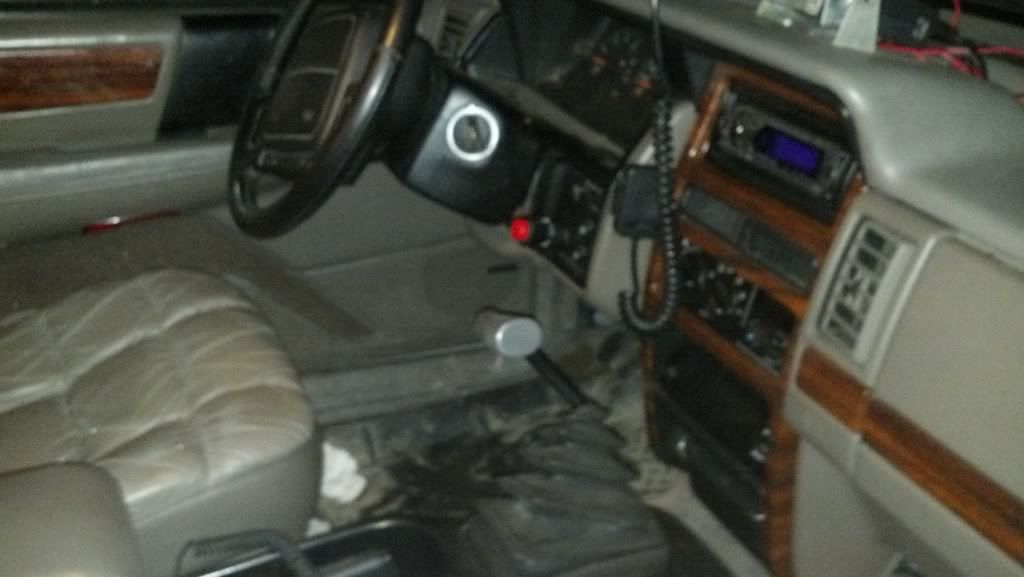

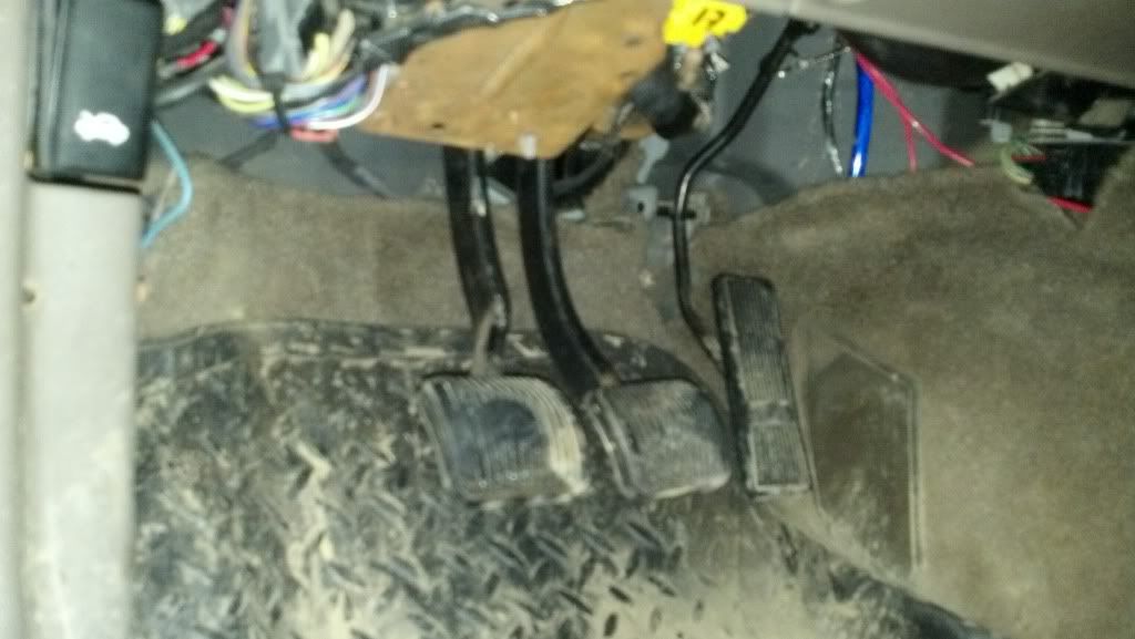

zj clutch master cylinder is definitely easier, i used the xj one
pedals, good luck finding them from a zj, i made mine from the factory bracket and the xj bracket with xj pedals

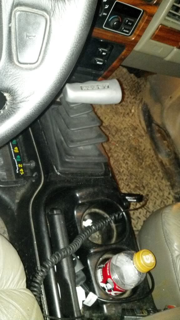

xj shifter works pretty well, i bent mine a lil to put it where i wanted it
tj inner shift boot works well
transmission preferrably with external slave, youll have a plumbing mess with the zj master if you try internal
transfer case of your choice
28.5" front driveshaft
36" rear driveshaft, which i have a nice beefy extra if anyones looking to do the swap
93-95 you can buy the oem trans mount from a local parts store, newer youll have to find the older crossmember or fab one, if youll be wheeling much i suggest just building one along with installing some hd motor mounts
cut a hole where your shifter used to be
transfercase linkage will need modified cut and lenghten/ shorted as necessary i cant remember which because i put a novak shifter in mine, i may have the heim joint rod i used originally
wiring with obd1 (93-95) is easy kill power to trans ecm, ground for neutral/ clutch safety switch to ecm and reverse lights
finish the interior to your liking
