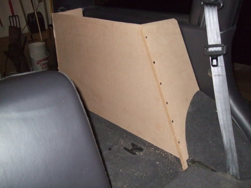

Is that box for one subwoofer? You could probably fit like four subs in that thing.
Where are you going to mount your amp?

A sealed enclosure needs to be built to the SPECS of THE SPEAKER. Volume will be determined by the speaker.
A ported enclosure will also be dictated by what speaker you run.
not all are made for sealed, and not all are made for ported/bandpass enclosures.
Just making a box of random dimensions may work, but not as well as a properly designed box.
Best advice yet. Pay attention to what the sub you are going to run likes. Some need a ported box, some you want full sealed enclosures.....

yeah mine is sealed and when i turned it sideways like this one so i had a little more storage room it sounded like Shht!

With the above setup he is going to have to go with a free air style woofer. It will sound like poopy.

First whether you face the sub sideways as shown or to the rear depends on your taste in music and what you want the sub to do. In the WJ, facing the sub to the rear will make the sub boomier and add volume, but will make it much harder to blend with your front stage. If you aren't doing a SQ set up and are just looking for some punchy bass, this way will be fine. If you are an audiophile and are trying to create an accurate and/or tranparent bottom end then the location you have is about as good as it gets in our Jeeps.
Also, as stated by others, the box volume should be calculated to match the sub. Ported enclosures are very touchy, and must be built just right to get optimum performance, I don't mess with them myself but thats just personal prefference. Sealed is much more forgiving, if you you are a little off in volume it won't be the end of the world. Either way, DO NOT USE THE MAUFACTURE'S RECOMENDED BOX VOLUME!! Run a model of the sub in winisd http://www.linearteam.dk/ to get your volume, and don't forget to account for the displacement of the sub itself.
Virmagicus,
Why would he use a free air sub in a sealed enclosure? There are quite a few subs that work well in both aplications, but a free air sub is designed to use you entire trunk (properly sealed of course), as an enclosure, where he will only end up with about a cubic foot of volume.

First off look at the size of the enclosure, way more than a cubic foot(closer to around 5 cubic feet). Also , there is no way that it can be sealed or even close to being "air tight" with the construction that he is using unless he is planning on backing off the box to lessen the cubic volume. Sealed enclosure/air tight-no, can he use a bass reflex design with a port hole?-no, it is not sealed. We will see how it is going to be backed off & what style sub and how many he is using to determine the correct volume.

Check this out:
http://www.audiobahn.com/Audiobahn06...ularBoxVol.htm
For wood thickness, I used 1/2" MDF board. Keep putting in sizes until you get the correct sq/ft for your woofer and setup.

Unless I am completely missing something, he is only making a mock up right now, he will use the panel deminsions from his mock up to make a real box. Also that box is nowhere near 5 cubic feet. Isisde there is the wheel well, the back panel, and the gas filler tube, all which take up space, If he has 1.5cf or more I would be supprised. I know this because I was going to build a fiberglass box in the same spot. Next if he dosen't build a sealed enclosue or air tight enclosure a free air sub won't help anyway, he will get tons of air noise from any leaks and it will sound like arse. A free air sub still needs and enclosure, just a much biger one. If you run a free air (or infinite baffle) sub without sealing the trunk properly it will sound like arse too. He can make that enclosure sealed, but it will take some care to work around all the stuf on that back wall. Not at all impossible, just time consuming.
tsconver,
I completly agree that most people will like the way you have yours set up better than side firing. The majority of people will never even try, or know how to properly blend the sub with the front stage. And there is nothing wrong with this, there are times when I prefer this type of set up too. A true SQ set up will blend seamlessly with the front to the point where you can hardly tell there is a sub there, but this is not what a lot of people want, they just want some bump. I just wanted to let the original poster know the diference, and clear up some of the issues of advice being given here.
The main thing to remember with audio is, all the advice in the world is no substitute for just trying. What sound great to one guy will sound like crap to another, you just need to listen for your self and set your system up how you like it.

Yes , I know this is a mock up. My only point was he would have to back off the box (from behind) in order to have a sealed enclosure & to lessen the cubic feet which is more now than what he needs. See how it is rounded off on the bottom.

I love the way mine sounds, I honestly can not tell where the bass comes from. Now people in the back seat are not so thrilled with it. THey do get a free massage though, :-)

Yeah he will lose alot of air space when he seals up the back (unless he uses fiberglass) but that is just the nature of the beast. He has to seal the box or he might as well not do it at all, there is no in between.

wow im surprised at the amount of response. yes i am using 1/2 inch mdf. i am very far from being done this box. im planning on building another closed box for just the sub and mount that inside of the existing box. the box im woking on now is more of an outer shell. as for the amp, im going to mount it on top of the outer box or under my back seat next to my current amp.

hey guiys thanks for all the advice. i will definatley keep all that in mind as im finishing up. here are a few more pictures of what i got done today.
