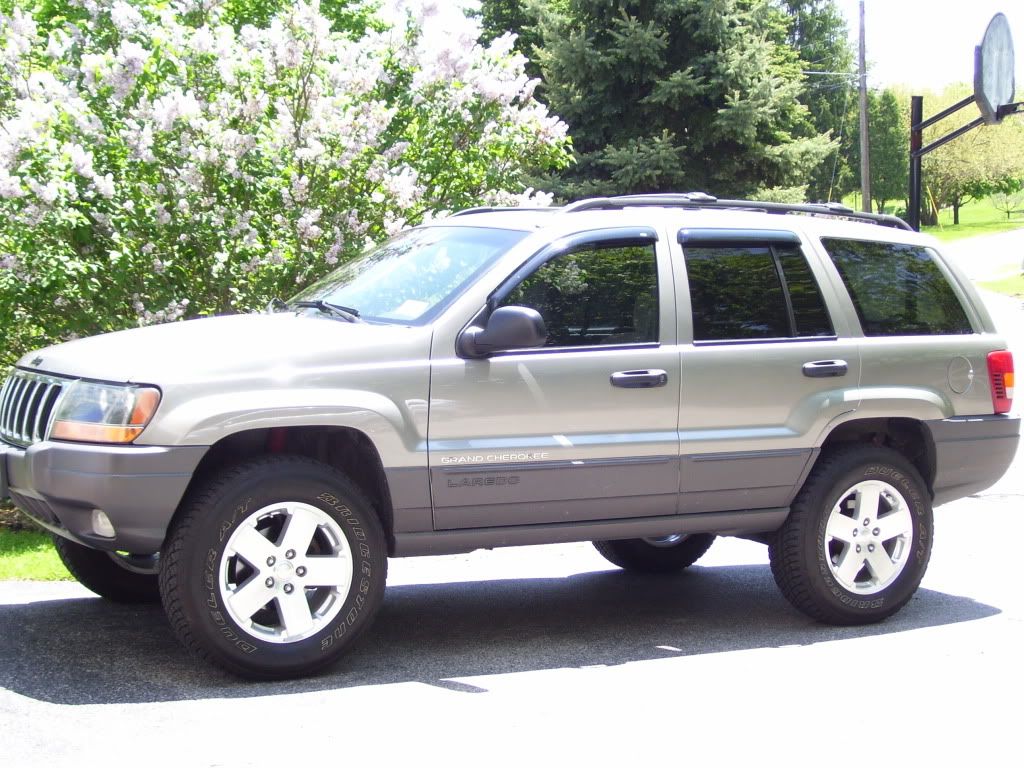

I have those rims and tires on mine and I only had to trim off about 1/4" off the bumper most of the rubbing was on the plastic guard protecting the fog lights and that stuff. I dont have wheel spacers yet but they are fine right now.

lapinski89 could you put up some pics of your setup. I really wanna know what this is going to look like. Thanks for the estimate gatorayde, seeing as i have never trimmed up my dub before im a little hesitant but 1/2'' doesnt sound too bad

2001 Laredo 4.0, 3" IRO, 31" Wrangler Duratracs

Damn that looks sexy and the color i have
