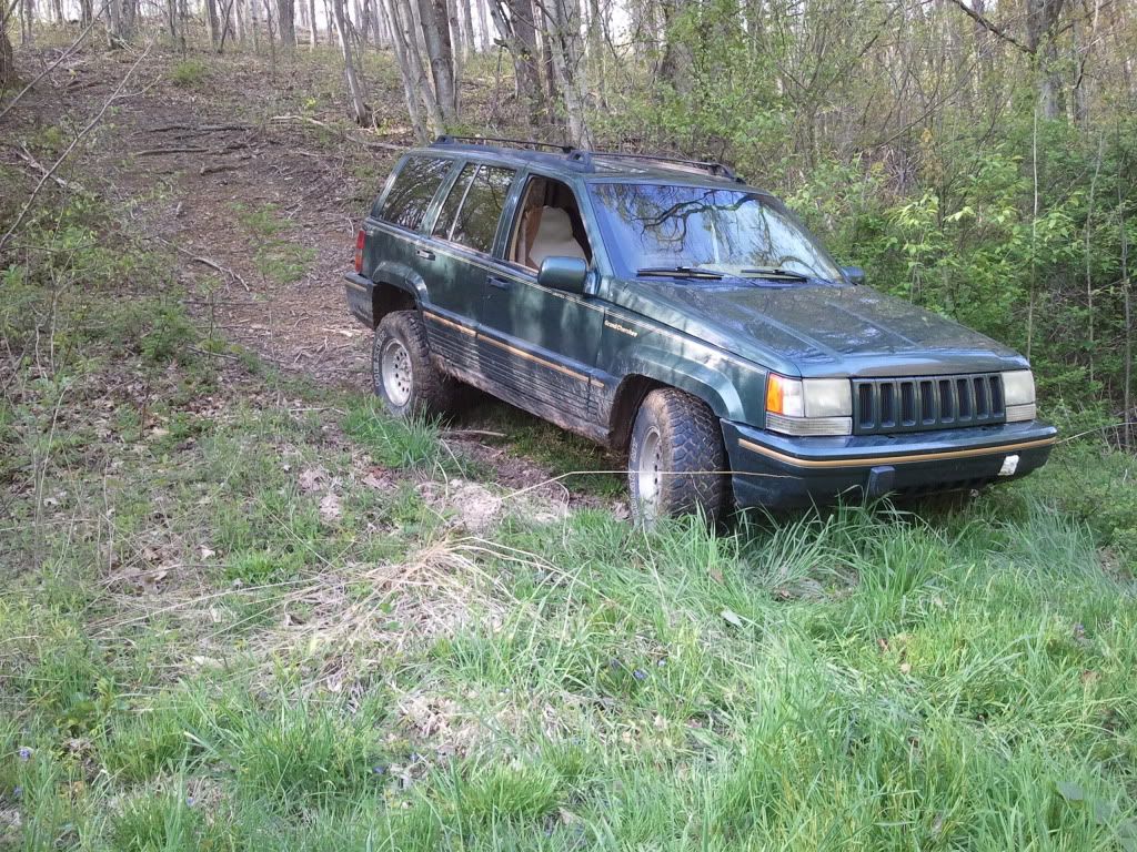

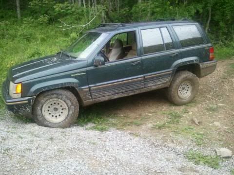

stock on 31s

Very nice, you have to trim much?

Didn't trim any thing but the mud guard things can't think of the actual name my mind went blank on me

How do you like your turning radius. I have 31's stock for a while but it really annoyed me after a few weeks so I took them off again until I get some rims with less backspace. And did you shim the steering stops or are you relying on your ears to not rub on the LCA and sway bar...

Turns fine. Didn't do anything but trims the plastic guards

Plastic gaurds, do you mean the inner fender? Do they rub at all at full flex?

15x7s and I'm not planning on trimming anything else I'm just waiting till tax time again and getting an RC 4 inch LA kit or rusty's off-road 5.5 LA KITif I can't wait that way ill do it cheap with iron rock off-road 3.5 lol

No bit my stock tires I ran we're like 28.5 and these measure 31.25 so about 3 inch or so.I kno I dont bottom out on stuff I used to.
