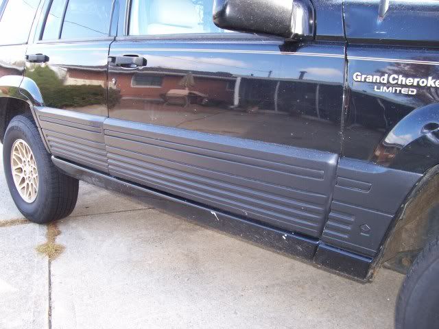

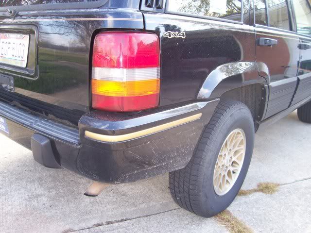

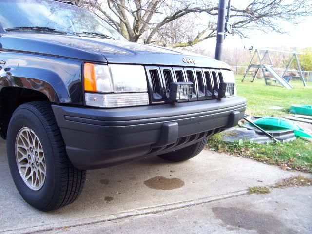

Prep wise, I just used Simple Green to degrease, then sanded with 100 grit, rinsed and let dry, and then started spraying with about 15 minutes between coats and left to dry overnight before reinstalling. I didn't use any primer, seems like most people here haven't had to use it.
I still have to do the rocker panels, planning on that this weekend...
Pics:
The look before, with gold stripe
After
