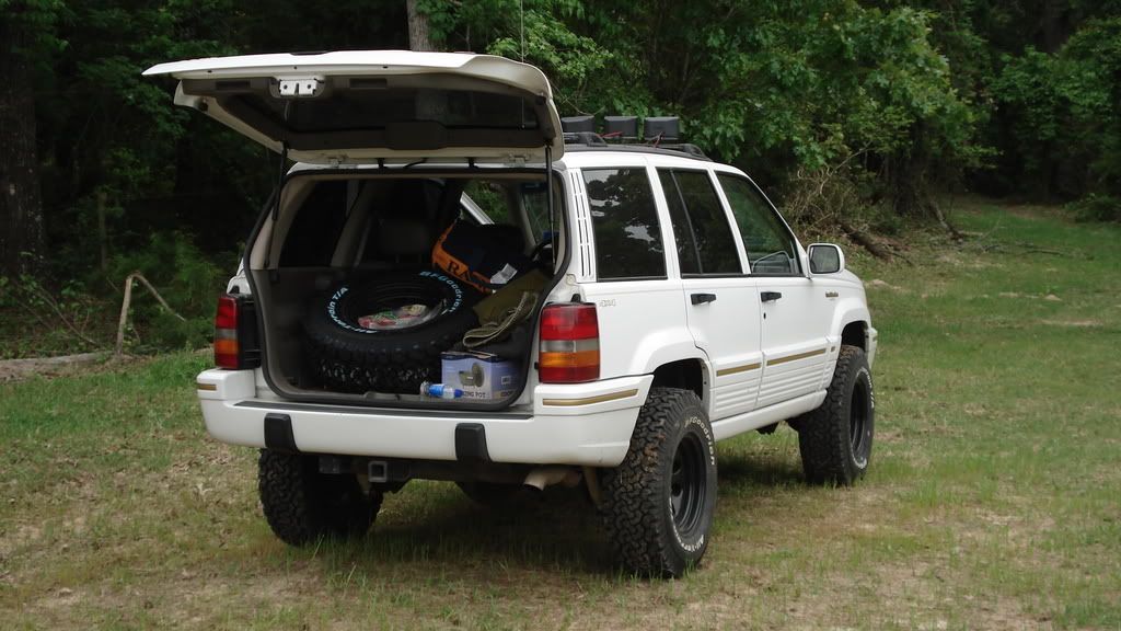

I know mines not all white, but you get the idea.
I'm running 1.25" Spidertrax spacers with TJ Ravine wheels.
