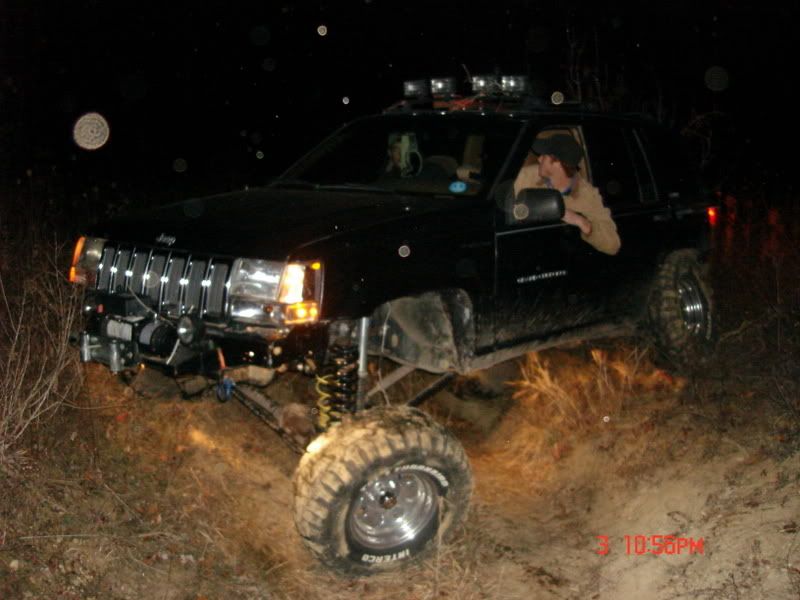

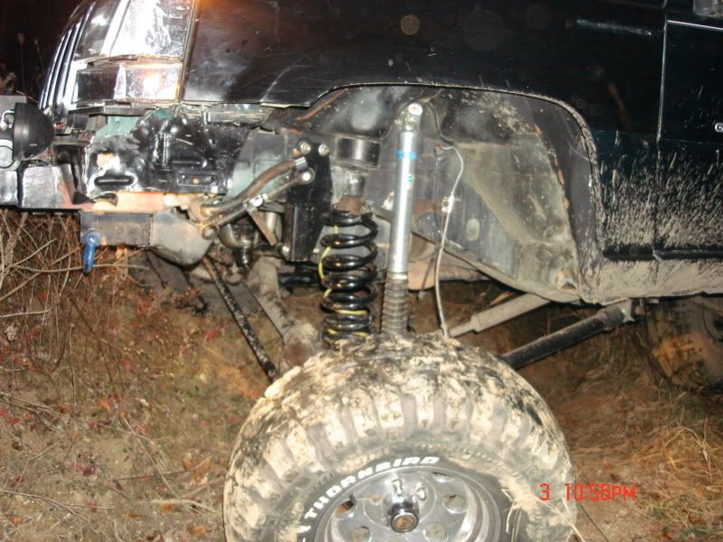

Have to throw a coule of flex pics with 35's. Thats not even maxed yet, still have about 4" more in the front and 6" out back.
