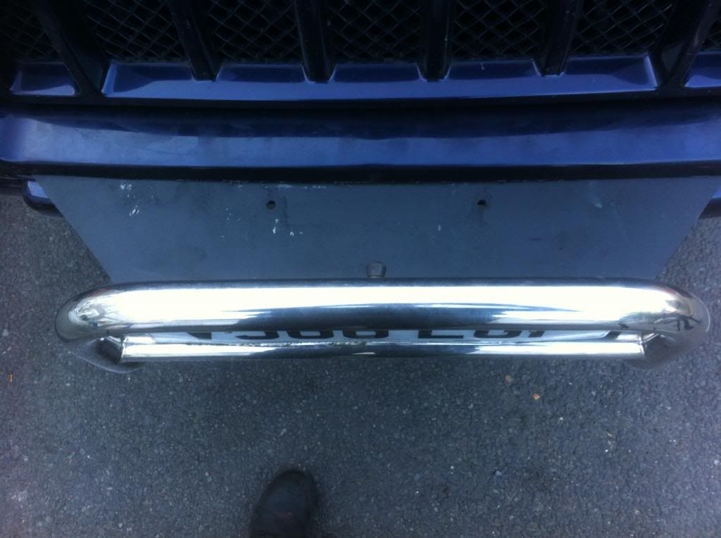

I wanted one of these but the cost in the UK is crazy... and shipping from the US would be more than the plate due to the weight....
There is one on Ebay for Price:US $229.95
LOL and the shipping is :- Shipping: $464.20 UPS Worldwide Expedited
HOWEVER.....
Reading the fitting instructions gave me to basics to have a go and build one from scratch..
The result
Winch to follow soon
A bar fitted for the time being just as a safety feature to stop people walking into a 1/4" steel plate
