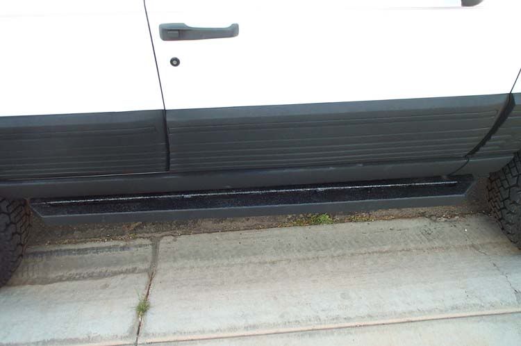

Here you go...
Rhino lining or duplicolor will not crack. Just keep it moist with tire shine or armor-all UV protectant every few weeks.

While i was in upstate NY last here i hit the local walmart for the first time and bought the huge paint can of duplicolor. I think i walked out with the whole duplicolor range, the touch up pens, heat paint etc!
I used the bedliner on a friends old YJ to line the entire tub and i was impressed with the finish. It is alot better than rhinolinings, which has a bubbly look to it. You cant see it in my posted pictures but up close it is a mess.

I decided to bite the bullet today, and I applied Duplicolor Bedliner Spray to all the plastic on the Jeep. I think it came out amazing, as 2 hours of labor and 26 bucks in supplies beats paying Line-X 600 for everything.
I will have some pics up soon, but I highly reccomend doing this it looks amazing. I applied 3 coats in total and it seems pretty thick, though only time will tell. Worst case scenario just apply another can down the road. I did not remove any bumper covers, and it came out just fine. I taped off the fog lights and put newspaper in front of the radiator up front, and in the rear I just took my time taping off lighting, trunk gaskets, etc.
Word of advice, buy the widest blue tape possible and on the sides, tape down some newspaper on the door panels. As careful as you are, the reality is you will get some overspray and when you pull the tape off it is a very defined line. Some paint thinner and elbow grease worked just fine, but it would be easier to just tape it off completely at first.
