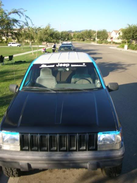

I just painted my grill with some rustoleum cuz I was waiting for my car to dry and said **** it. Took the grill off sanded it down, primered it and painted it. I still need to add a few coats on and than clear coat it and ill be done but here is what it looks like. I took it off roading and no paint has chipped or anything. The only chipping that I am seeing so far is on the plastic cladding...

That looks good! Did you have to sand off all the silver color first?

Nope, just rough it up some, clean it off, primer, then paint.
And if I were you, I wouldn't use rhinolining/herculiner on the cladding. I've heard from other people on this site that they start to come off after a couple months. If you really want it black, get some krylon fusion for it or you can just take the plastic cladding off and then put the rhino/herculiner on the metal(prep first, of course).
