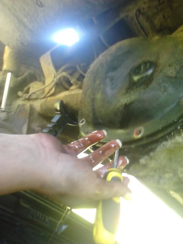

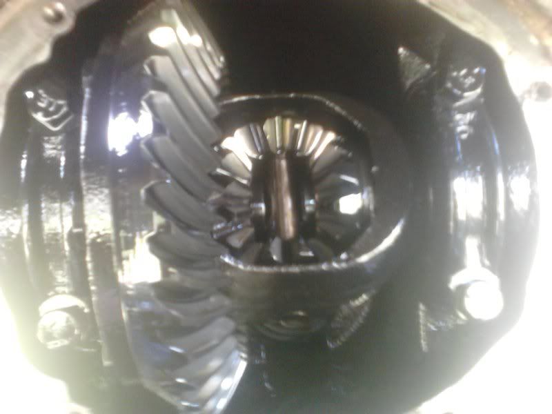

Hey about a month ago i took my zj out to trails all weekend after that i took it agian in sugar sand and its like my rear end froze up it started shakin real bad vibrating and loud clunking noise, then after a few trys with exseleration it went back to normal and made it out (in 2 wheel) so i decided to take the diff cover off n check my gears everything was awsome oil was clean no shavings or metal n e where and gears were perfect aswell as pin

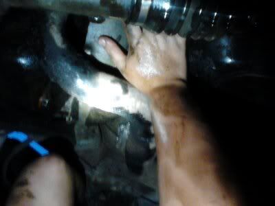

well the i changed the diff oil and it didnt do it agian well now its a month later n i hit the trails n ran into some sugar sand n it did it agian.. so now back at square one my axles are good bearings good seals good u joints good all tight aswell so i moved rear driveshaft up n down in N and like norm had some play in shaft but wht i didnt like is where my boot is on my cv joint it seems to have too much play in my opioun also found a nice size leak in tranny lines so i replaced them as well..

and other then that any other ideas or any one had this happen before? thank yall for your help
