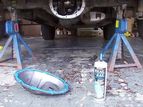

Thanks to everyone for the info. Based on y'alls comments I'm going to open it up and change the oil myself to see how it looks in there. Also check the vent tube. Should I use 75-140 or 80-90 w/friction mod?
I checked the original invoice and it is the Trak-Loc rear diff. Its definitely more of a bearing noise, not a howling gear noise.
