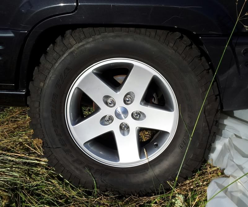

I switched the arms around and set the rear arms to 17.25" per RE instructions. Here's a pic of it flexed up in the well.
Now I've got 3/4" in front and 3/8" in the back with it tucked. Now I need to work on bump stops.
