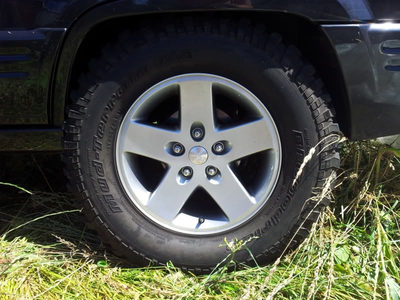

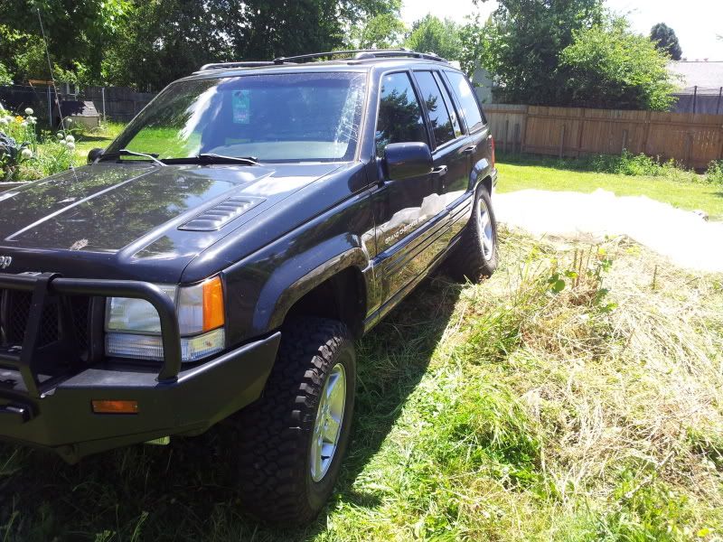

I understand that the axle moves back as it travels up. But I'm running fixed length rear lower arms designed for a maximum 31" tire. I'm running a 32" tire. So instead of having an inch between the front of the well and the tire I have a little less than 1/2". It's too close for comfort. I'll take a pic of how close it is, and get a pic of it up in the well. So you can see how much room I have left. I'd prefer to leave the fender well alone and trim the bumper instead. Or replace it.

Well I guess I'll get the tire further into the well. Is it ok to have the tire so close to the wheel well?

its fine for the tire to be close to the front of the wheel well. you do not want it farther back, if it was, it would contact when compressed. is there another way i can explain this so you get it?

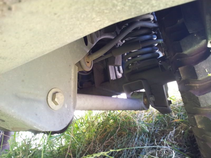

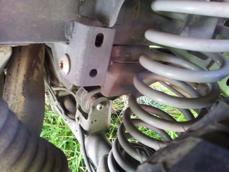

I'll look under and see if I have bump stops. I still have room behind the tire, and a lot of room above the tire in the wheel well.
I'll take some more pics today, I should've taken a shot of the whole wheel well.

WhiteOut's Avatar
Posts: 8,204
You need 3-4" of bumpstop in there.

Posts: 333
Is that as far as the tire is supposed to come up? I guess I was expecting more. That still doesn't address my rubbing. The tire comes down at least another inch before if stops rubbing. If I had adjustable arms couldn't I get another couple inches of up travel without rubbing? Either way I need taller bump stops.
