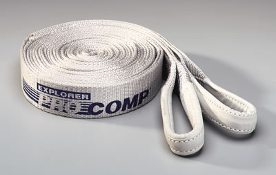

My tow strap showed up and looks plenty beefy. ProComp 20,000 lb. This is to replace my Harbor Freight special.
