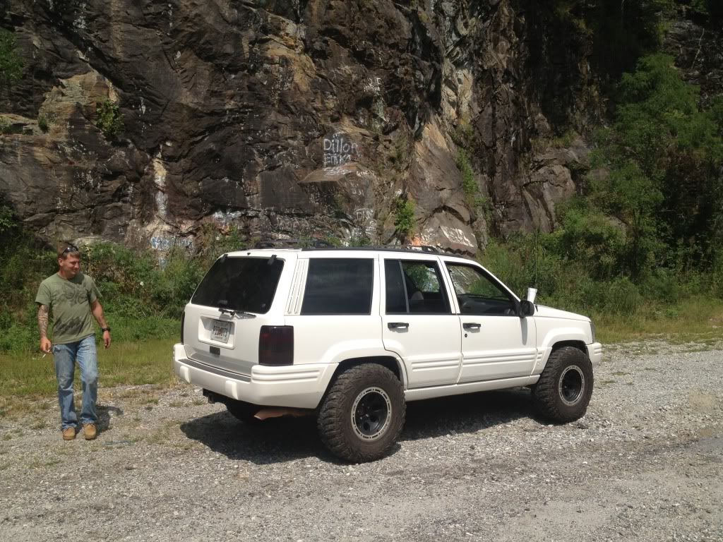

I had some people stating that they would never run this size tires without a lift, and it would rub non stop. Which pretty much made it seem like I have no clue what I am doing, with that said I am posting a few more pictures of the 31" tire fitment on stock suspension with slight trimming and hammering! There is no rubbing when driving, full lock turning, or any normal driving conditions. However they do rub with the sway bar disconnected when attempting to flex, this will be fixed once I decide to cut and bend some more metal.
Passenger side.
Driver side.
Texsun is offline

Wow! Don't know how you fit 31s...everyone tells me 30s don't fit on my stock 95

To be totally honest the trimming really didn't make that big of an improvement, I could have gotten away with 1/4 of the amount of trimming than was done. Also the pulverizing the pinch seems some and the wheels made a huge improvement!

We have had these wheels sitting around for years, if I rememebr correctly it's 3.5" but I may be wrong. I will get exact tomorrow for you. Any other questions? This photo below is the outline that I taped off for the trimming, however would have been perfectly fine with only 1/4 of this trimmed.
after
Who said you can't flex stock suspension and 31s? This isn't much flex, but the tire is actually off the ground!
