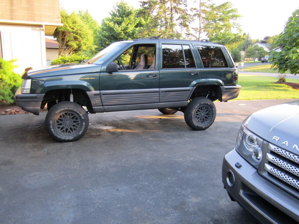

here is a link to some pics http://www.jeepforum.com/forum/f13/w...l#post11673927
I lightly sandblasted the original rims to etch then I sanded the rim edge smoother with a 220 grit and masked that off and primed the rims with a black epoxy primer then hit two coats of single stage polyurethane black then unmasked the rim edge then I hit two coats of urethane over everything to keep the bare aluminum fresh looking. I also balaced it so that my wheel weights are in the inside. New lug nuts and voila! looks aftermarket.

Straightpipe...
Love what you did with your jeep!
The before picture looks almost exactly like mine, except my 93's got the stock running boards.
That second picture is what I want it to look like!
How did you do your rims? Do you have to take the tires off the rim to paint them? Or is it just a lot of taping?
I like the pics of Whiteout's rims. I was thinking about redoing mine silver, but now that I've seen the complete black look, I'm thinking of doing that.
