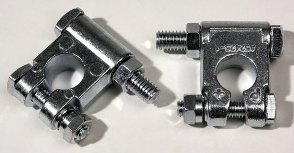

These are the best battery terminals you can use...
These, battery terminal grease and post covers are the best solution out there.

Ok,dont hold out on us,where does one find those?
dusterdude is offline
post #15 of 26 Old 08-01-2013, 10:25 PM
dylantheheeler
Location: Smithville, Texas
Posts: 245
Those are military battery terminals,
Seen here:
http://www.prime4x4.com/shop/OffRoad...MilTerm001.htm
I just used marine terminals with cable lugs. Same concept as the military terminals, except the posts are vertical and have wing nuts.
