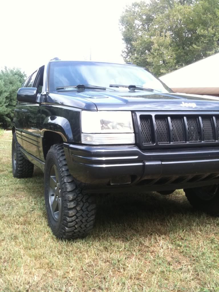

I run the OME HD coils and Kolak is right, they net around 2.5". I am running 32's (255/75R17) and have adjustable control arms so they sit in the wheel wells correctly and I can stuff them up in the wheel wells really well. 33's will work with adjustable CA's but you won't have much uptravel and will have to bump stop quite a bit to keep from bashing your quarters. 245/75R16s are probably the best size for this lift, but I don't wheel mine that hard as it's my DD.
Do you have some pics of yours? Would I have better chances of fitting 33s if I dome OME HD and then 1 or 2 spring isolators?
And is that all I would need? Coils, shocks and adjustable CA's?

Kolak knows what's up, awesome knowledge in that man! I built my lift for a great ride and to tow with. I don't wheel it much so uptravel wasn't too much of a concern of mine, but I do have a fair bit of downtravel as my shocks are for a 3.5" lift. It rides great, handles well and looks exactly how I want it to (well it will after the ARB is installed). Here's a couple pics.
Looks great! I'd throw some 1.5" spacers on there to give it a little more aggressive stance, but other than that I love it.
Thanks!
It already has spacers though as you need adapters to convert the bolt patter for the JK Moabs. I think it sits perfect, right at the edge of the wheel well.
