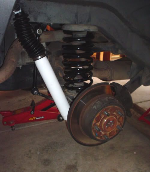

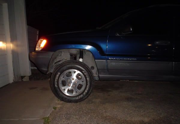

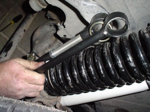

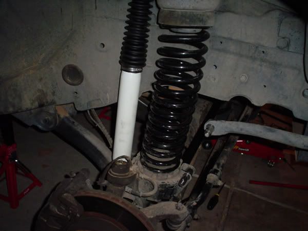

Ok, I started my 3" IRO lift with DT8000 shock and Disconnects..... Remember I'm a newbie or was a newbi to lifts.
All I can say is WOW!!! What a project. But man I've learned a lot. 5 hours of work and we only have the front done. Better planning and less trips to the auto parts store could have sped up the process.
My Questions:

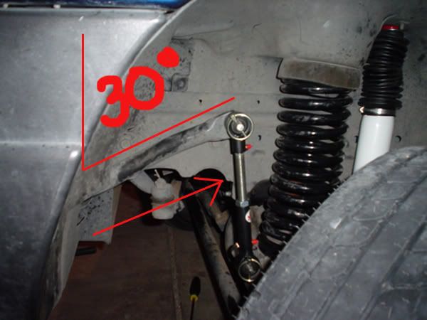

1. How extended do the discos need to be. Look at my pics are they screwed out to much? I tried linning them up with the bars that came with the lift and they are still shorter.
2. The intructions said the bar should be angled 30degrees. Looking at my picture does it look right?
3. Please tell me rear will be easier than the front???

Sweet - lookin good man. I can't believe those sway bar extensions are so long. If you are lifting the body ~3" I would imagine the extensions to be like, 4" - not 8" or 10" or whatever those are. Can someone explain this?

I would eyeball the extensions to have the swaybar in the 15 degree area at most.

Make sure you don't have the extensions over extended.

They look fine. You can adjust them as needed after a test drive, I had mine too short and it resulted in about 0 body roll and a bit stiffer of a ride, made them longer and it softened up a bit. But that looks OK. The rears are suppose to be a bit longer.
Did you get a adjustable or fixed track bar ?
I had a worse time doing the rear, but you don't have to deal with the a-arm spacer
I would soak all of the shock bolts/swaybar bolts with PB blaster or wd40 and let it sit fo ra while before tackling it.

I'd rotate discos with zerk fittings to the front. Would be much easier to grease them. I'm surprised JKS wants 30' for WJs. (JKS 3100). for ZJ's it's only 10'

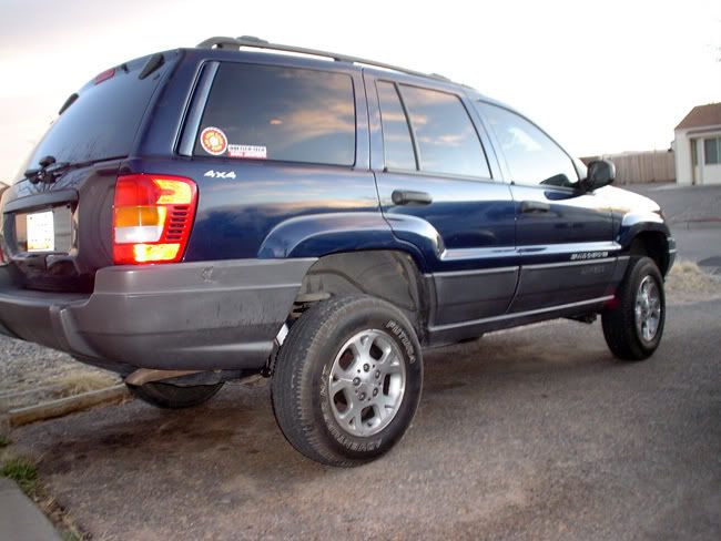

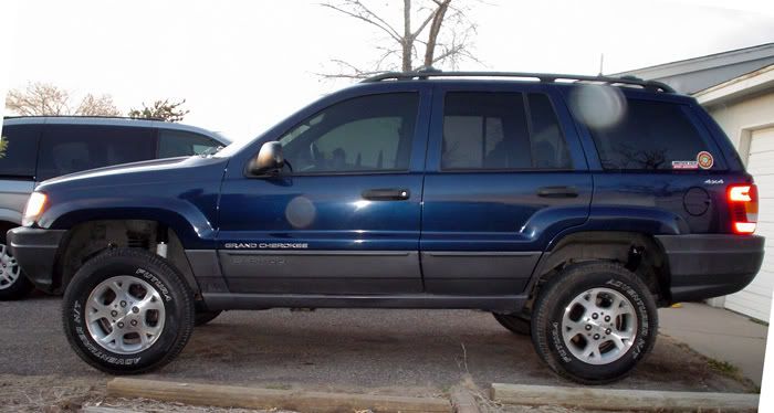

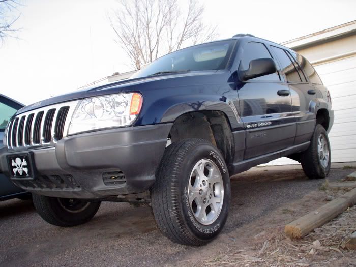

Heres some pics!
rear side
Before
After
