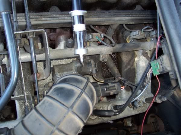

Anyone got a pic of the front hose going to the air filter box? Im curious because mine may be about twice the size of the stock hose.

Mine is a plastic tube about ½ inch OD with rubber fittings on each end.

Here is the tube at the very left of the pic.

Thanks for the pic! I thought mine was a bit large.
I replaced both elbows and such not a year ago and when i changed my air filter the other day i noticed oil coming in that front hose.
I just popped a smaller diameter hose on there, seems like i read somewhere the size of the hose was important but im too lazy to search today.
Not even going to ask what that suction looking device is there!
