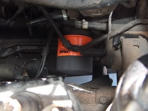

Originally Posted by rs2.bull
I must disagree. I just finished removing the 90 degree adapter from my 1994 Grand Cherokee Laredo. There is enough clearance to put the filter back on. I used the procedure that was mentioned earlier in this thread, regarding a 1993 GC and mounted the filter directly to the engine block. I could not get the split guide pin out with vicegrips as described so I cut it off with a Dremill tool. So it will work on '93 and '94 for sure.
Not saying that it wouldnt work using other filters but what brand did you use. I know that the difference in walmart filters like fram and supertech is noticeable.

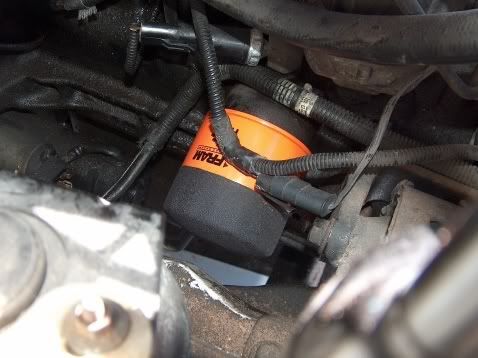

rs2.bull
2005 WK
Join Date: May 2007
Location: canada
Posts: 15
I tried it with a Fram PH16 and a Motomaster PH16 (Canadian Tire Brand) and both have no problem going on or off. I didn't measure the actual length of either filter but will later.
I've just taken a couple of pictures
Edit: Just measured the filters I have:
Fram PH16 ...........is 3 11/16" long
Motomaster PH16 is 3 3/4" long

post #34 of 138 Old 09-17-2007, 10:17 PM
indept
Location: New Jersey
Posts: 1,322
You really beat the crap out of that frame getting the adaptor off
indept is offline
post #35 of 138 Old 09-17-2007, 10:43 PM
rs2.bull
2005 WK
Join Date: May 2007
Location: canada
Posts: 15
Actually, I used a small pipe wrench with a piece of pipe on it and never touched the frame at all. Mine came off pretty easy....about 5 minutes and it was off.
I see what you saying by the looks of the picture but that's actually white paint under grease and oil. My ZJ is painted white. There is not one ding in that frame .......just alot of grease and oil from the leaking adapter
rs2.bull is offline
