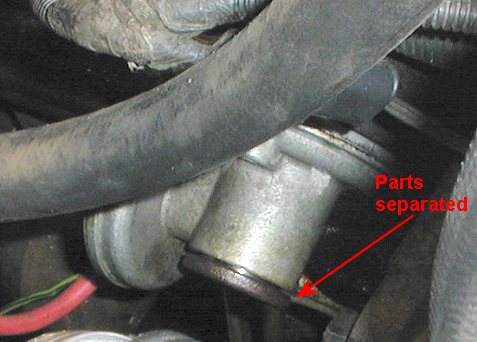

My I6 also has a T60 bolt in the center of the oil filter housing. I could not use a T60 bit on a ratchet because there was no clearance in between the housing and the frame.
I ground two edges on a T60 bit so that I was able to slip a 23mm wrench on the bit.
I started on the top of the motor. I slipped a 2-ft pipe on the end of the wrench and I was able to break the bolt free with a lot of force. After I broke it free I went underneath the vehicle to loosen the bolt. There is more clearance to swing the wrench under the motor.
As I was loosening the bolt I noticed that the bolt was not coming out of the housing. The housing was pulling off the block with the bolt and the bolt was hard to turn. I could not turn the bolt by hand so I had to continue to use the T60. I soon ran out of room in between the frame and the T60 bit. I screwed the bolt back in most of the way and then used a screwdriver to separate the two parts while they were still on the block.
After that it came off easily by hand.

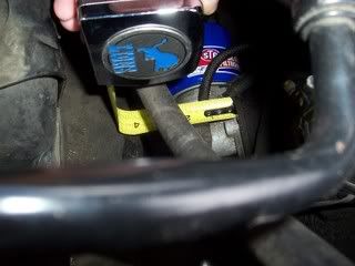

I have a 93 ZJ 4.0. When I discovered the leak from the adapter(about a quart a week) I pulled off the adapter and noticed that the threaded nipple that the oil filter screws on to was also threaded into the adapter itself. I used a 1" socket and took it out, it is the same thread on both sides. I screwed this right into the block and removed the lcating pin with some vice-grips. I used a Fram PH16 filter and now it mounts directly to the block with plenty of room to get the filter in and out. I did this about a month ago and I have had zero leakage.
Has anyone out there done the same thing? I was wondering if there could be any possible side affects other than eliminating the adapter?
I have been trying to think of why that adapter was there to begin with, if when it is removed the filter can fit fine without it.

The purpose of the 90 oil filter adaptor is to provide enough room for a filter. If the adaptor is eliminated then that allows only 4 inches of space (as seen below) A typical oil filter is 4 inches long. So removing the adaptor altogether will not work, as you need even more space to thread the filter on due to the nipple length

I had no problem getting the oil filter to mount straight to the block without the adapter. There was plenty of room. As soon as I can I will post a pic. There is a bit of a down angle from the mounting surface to the block, so I think that helps with the clearance issue.

Nice, what did that ruler come free with a subscription to SI?
