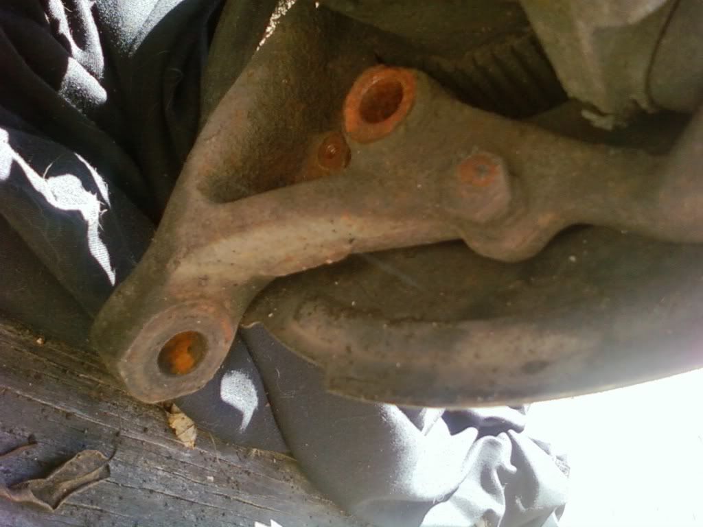

you say this happens while sitting still? parked? I would just say its the power steering pump moaning. You are probably just hitting the steering stop and you can turn the wheel just a little more working the pump. Ugh, I will edit, I gotta go outside and check I can't remember if you can adjust the steering stops or not.
EDIT: Yes you can adjust them, they are on the opposite side of the caliper.
Here is a pic of the steering stop.

Ahhhhhhh cool....... Thanks for the pic 98mopar.
After thinking about it, that might be it. Now that the rain has stopped I can look. Guess I'll just compare to the right side.
My thought is that the mechanic who did the front end work for the previous owner never adjusted it.

If the sound happens when you turn left, I would get under there and have a friend turn the wheel and rock it slightly back and forth and see if the left wheel stops before the right one. The left turn adjustment will be on the right (passenger) steering knuckle.
